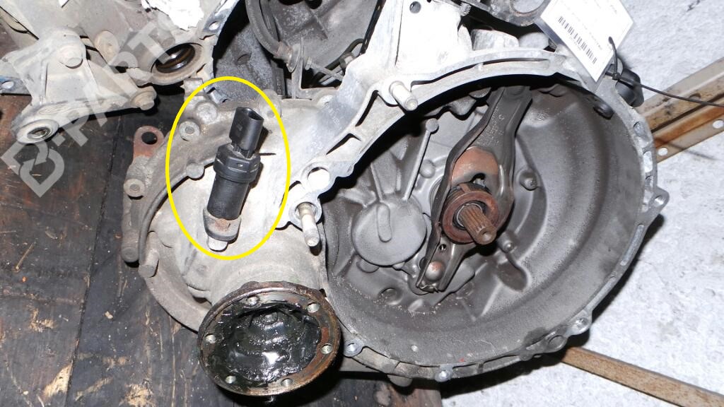

On early cars, or maybe just non-ABS cars there was a speedometer sensor G22 on the gearbox. That fed straight into the cluster electronics.
You'll not have that sensor on your car though.
Now though, I think everything vehicle speed-related is picked up from the ABS wheel speed sensors and the results of the computation sent from the ABS module to the cluster via CAN messaging, as would the engine speed from G28 (crank sensor) via decoding/processing from the engine ECU.
So if you use the existing ABS module, vehicle speed might still be OK, but if the cluster and new engine ECU don't play nicely together you're going to get nowhere, I think, with rpm.
If you want to see if the engine can start/run without the cluster, remove fuses 1 and 16 (IIRC) from the cabin fusebox, and give it a go.

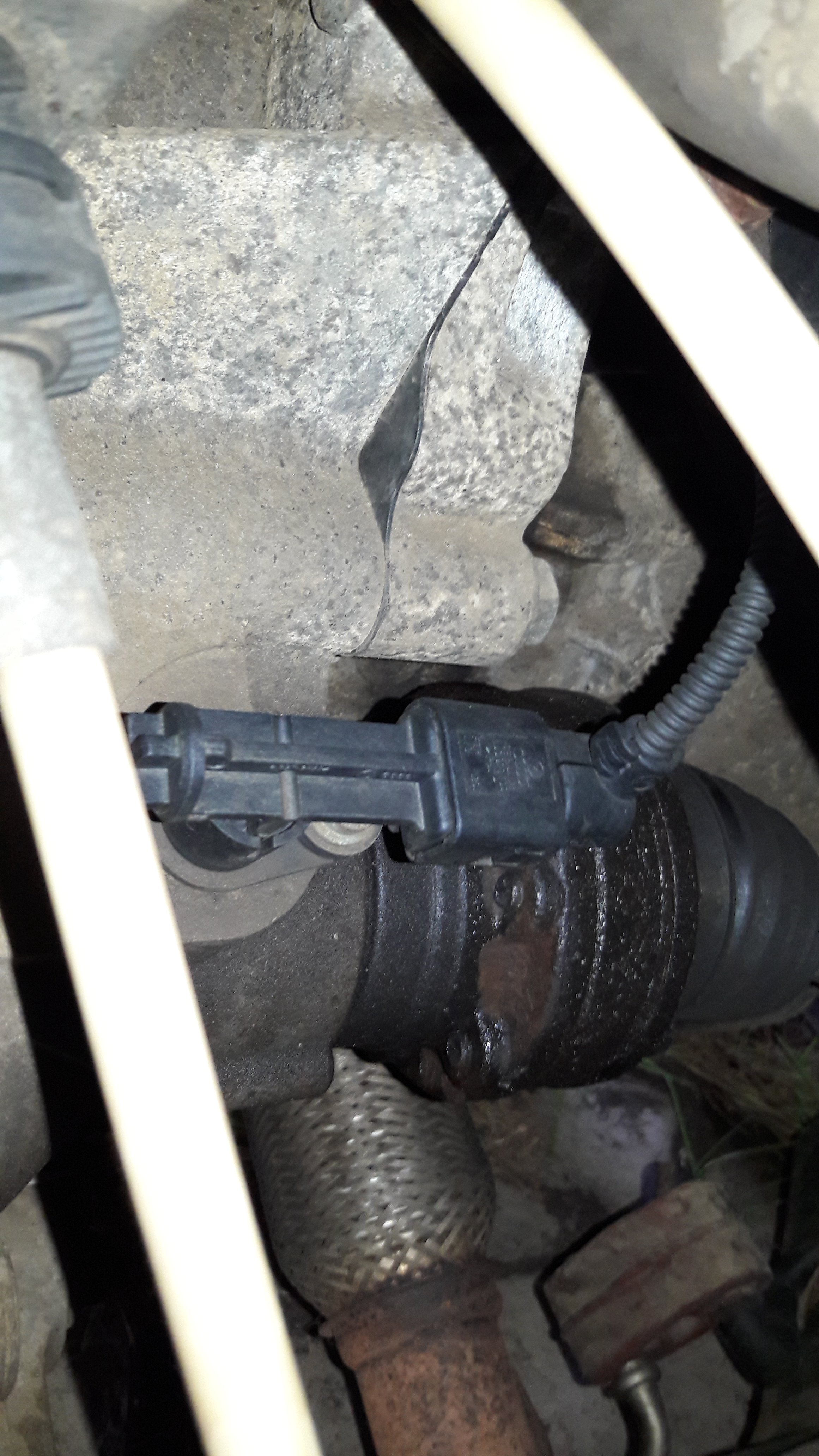

Mine has ABS but the speedo sensor is on the gearbox.

Are you sure it's not a dummy sensor Lee?
No, got wires going to it.
  • Sponsor
So do the dummies, bizarrely.

This is exactly the same as mine...

Here's a pic of the dummy, with loom connected:
That looks like a real one.  Mystery thickens...:D

Yeah they changed in 2002/3. My Fabia has a manual drive for the speedo that I wired back in after the engine conversion.
  • Sponsor
Still can't find that, but on the wiring diagram for a BMD for 2005 this note is double starred off the G22 bit of the cluster circuit
** not valid for vehicles with ABS/ ABS with TCS/ ABS with EDL and TCS/ESP
I'll have a look for your 2003 AQW in a sec Lee.
  • Sponsor
There it is; for the November 2002 onwards AQW diagram, it has a note for G22: "* not valid for vehicles with ABS/ ABS with EDL and TCS/ ESP"
Maybe your car was manufactured before Nov 2002? but registered on an 03-plate?
