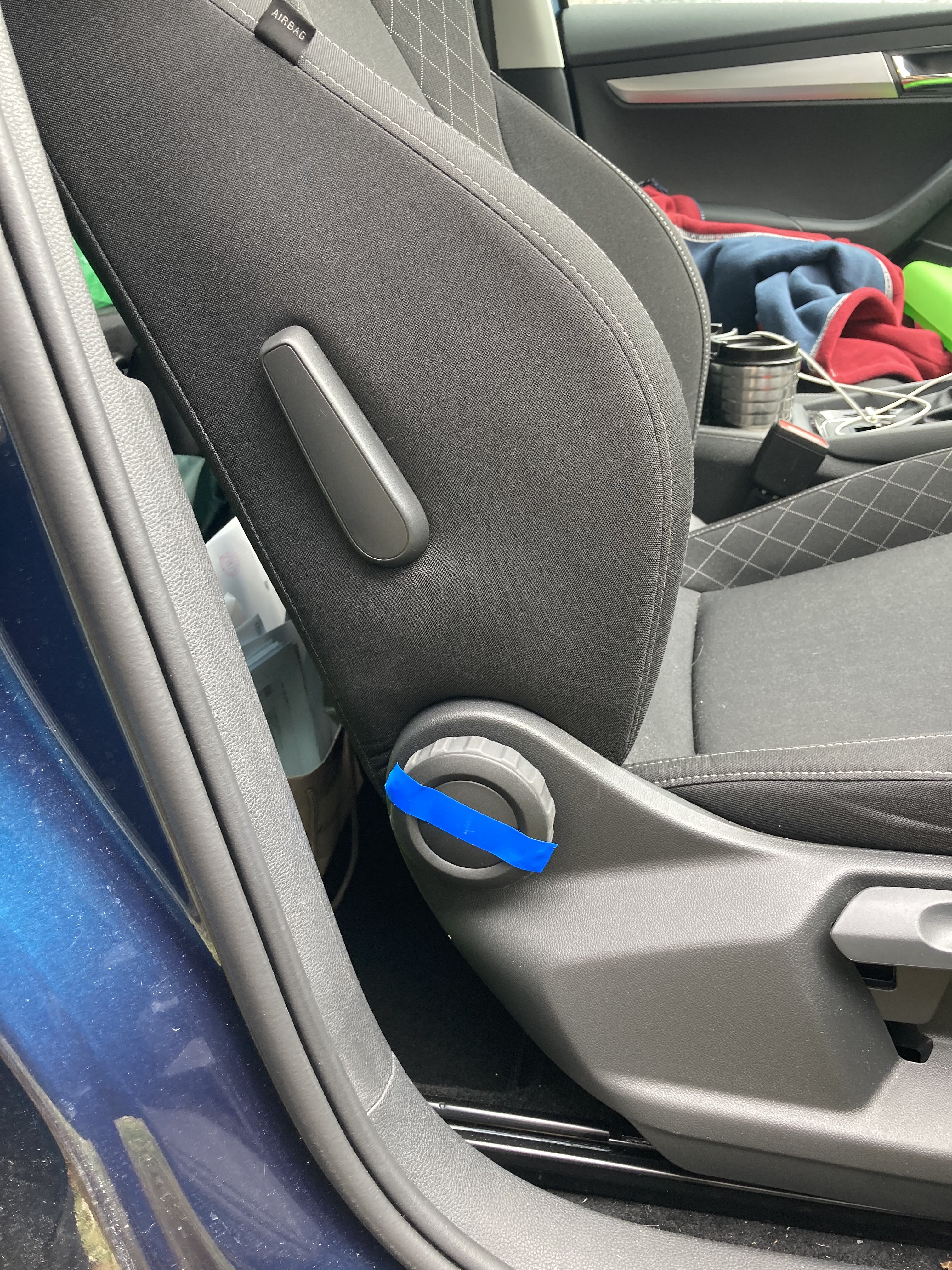

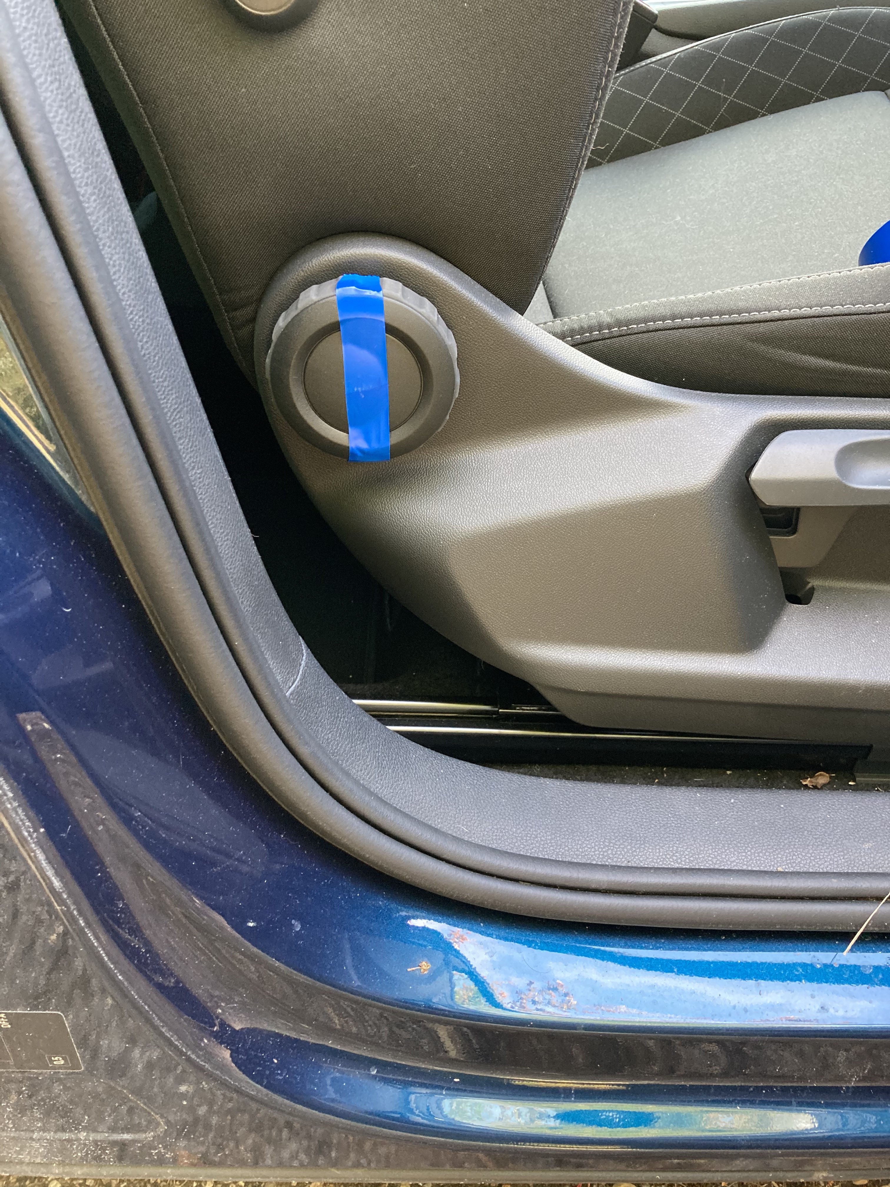

Right, 555 miles long hauling with no adjusting, seat went from:
to:
Deffo needs sorted but will wait until the 1st service in December.  SWMBO did wonder why I’d started driving with the seat so reclined, as pointed out above it’s so gradual I didn’t notice.
