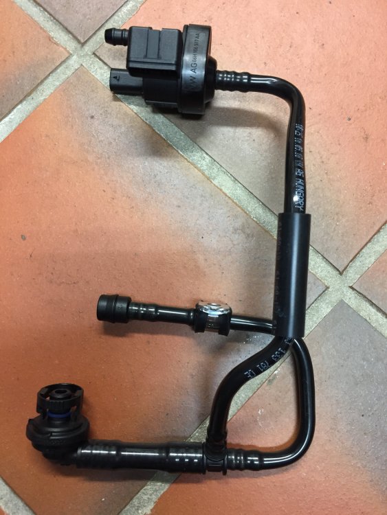

So I ordered a new N80 purge valve.  I was expecting it to be just a replacement valve (a hose connection at each end, and a single electrical connection).
I quoted the part number off the old item to the dealer 06H 906 517 H but they had trouble finding it.  They came back to me with a different part number 06J 133 781 CE which is the valve plus a number of hoses attached.  See image below.
Two of the hoses connect underneath the inlet manifold and what I thought was going to be a trivial job now looks much more involved.
The second (middle) hose just looks wrong when I held it up against an old inlet manifold I had in the garage.
So I have a few questions:
1) Does this look like the right part?
2) If it is right, then is it just a case of removing the throttle body below the manifold to get access to the relevant hoses?
3) Do I need to do a VCDS alignment of the throttle body afterwards?
I’m hoping someone can advise me if I’m on the right tracks here.

Can you call another skoda dealer or tps centre and just quote your car details and ask for the evap purge and see if it is what you have been provided?  If the pipework does not fit / have the same connections it seems unlikely to be the correct part. Is there a part number stamped on just the purge vale?
If it is the correct valve, I suppose you could try to remove the hoses from the new valve and plumb into existing?
PS Bosch:  0 280 142 446
Maybe an equivalanet it just lists 06H 906 517 no revision code.
Edited by TheClient
OK. So checked mine. My car is same model and year. And Mine has also 06H 906 517 H fitted.  From what I can see on the first run of pipe of your replacement set seems to mirror what is in mine. I can't see the remaining hoses without some disassembly.
The mk6 GTI shares the same engine.  This thread (from the US) confirms exactly what you have been told.  https://www.golfmk6.com/forums/showthread.php?t=96166
Also confirms it can be done without removing the IM but it is fiddly.
How much difference there could be with this hose set and N80 versus the many individual N80 PV replacements and OEM parts I do not know.
Thanks for your reply @TheClient
I just happened to be passing a Skoda dealer when I was down in the New Forest this morning so I popped in and they confirmed that the part I have is the correct one.
The new valve itself has the same number with a different suffix - 06H 906 517 AA.  I bet you have to buy the whole hose assembly like I have.
Glad I have the right part but I feel slightly sickened having forked out £650 earlier this year the have the manifold replaced due to the flap position sensor issues.  This EVAP valve could have been replaced at that point at zero labour cost.  Oh well....
Thanks for your help.
I'm sure you know this, but the general rule with suffix codes is go for the same as fitted or later. AA is later than H. But there are exceptions where some revisions suit some manufacture periods and later revisions other periods and multiple suffix versions remain current. Some with access to part catalogues can drill into the detail. .
