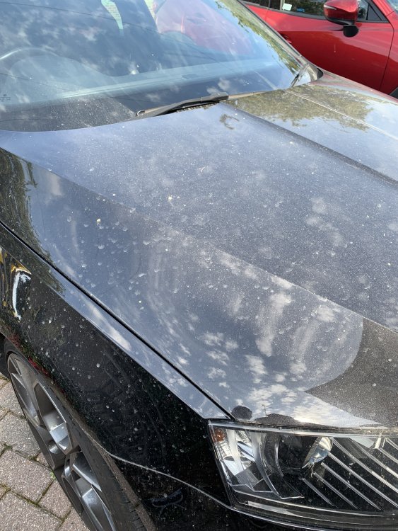

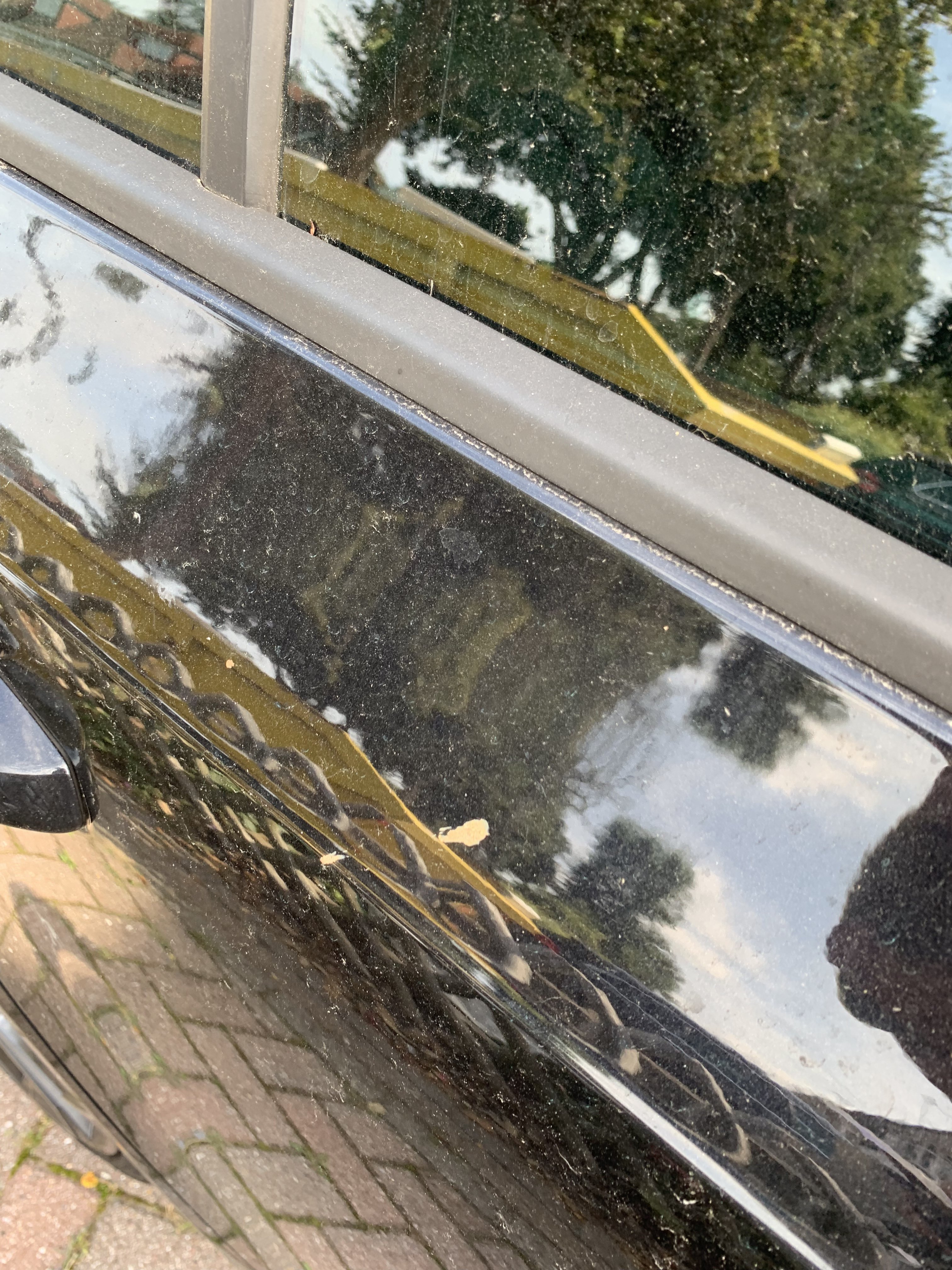

Hi, we have been away for two weeks on a holiday to Turkey. I have come home to find that me neighbour has had builders in to build retaining walls in their garden. It would appear that the builder has knocked up the mortar in a cement mixer on the drive and splattered it up one side of my car. Are there any products you would recommend to loosen the mortar. I suspect it has been on my paintwork for at least 10 days.
The car is overdue a good exterior valet and machine polish but I want to remove the worst of it.

What a nice thing to come home to. Would have thought your neighbour or the builder would have had the decency to cover it with a sheet or something. I would hose it down, give it a good soaking and see what comes off. Get some buckets of hot soapy water (detergent) and throw over it and leave to soak and pressure wash it off. Be careful using any brushes or cleaning cloths while there is still mortar on there for fear of scratching the surface.

Snow foam and rinse a few times before any contact.
But the mortar may have damaged the paint if sat for 10 days.
You need the name of the builder, and a professional detailer and take photos at every stage as this may end up as an insurance claim.

Unfortunately the mortar once removed will leave marks due to it being alkaline. Best to talk to your neighbour about putting it right and if it was me I would be claiming off their household insurance via the car insurance cover.
Ouch. Someone else should be paying a professional detailer to fix this. Pressure from a water jet could still damage the paint. A good Traffic Film Remover followed by snow foam may be a safe option
I'd this decades ago on a black Polo. Needed a professional chemical mortar remover plus a valet.
The cement in the mortar will generate heat, that's part of its hardening process. I would suspect the damage has already been done! I'd seek professional help and be having words with the neighbour!

Most of it looks like airborn dust that has settled & then dew or rain has finished the job, the rest of the splatters are probably where they hosed down the mixer and any mortar that dropped on the floor.

My advice is to wash it gently and with care, dont be concerned that some remains and definitely dont try harder on those areas, it will come away gradually with each wash.
