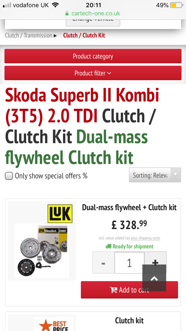

Quick search came up with this

£2,000 plus the initial £90 diagnostic fee with VAT on top, so £2,508 for an (unknown brand) clutch and flywheel fitted to a 2WD Skoda Superb?
@Anglosaxon is the location in your profile the name of the "good independent" that quoted you? Might explain things! Either that or your real location is central London.
As mentioned earlier, I paid £600 for an LUK clutch and dual mass flywheel (DMF) at a local independent. This was on my 2011 2WD 2.0 TDI CR140 manual Superb, excluding the slave cylinder, and was a few years ago now (December 2016).
Be aware though that my Superb has a manual gearbox. I see that yours is a DSG. I'm assuming that the removal of a DSG gearbox may well be more complicated, and therefore take longer / cost more labour versus my manual box. Isn't DSG a twin clutch system?...
Unless the DSG does indeed bring with it a whole load more cost, I can only assume that the garage who have quoted you have misquoted or misunderstood the work required.
Whilst not applicable to you, the reason for my new DMF was the well documented weakness built into the Sachs flywheel pressure plate that unfortunately plagues a lot of Superb's from the same era mine was built. Luckily, thanks to this forum I was able to hear and recognise the symptoms before it was able to take the gearbox out with it, so be sure to ask which brand of components the garage is quoting for...
If the price you've been quoted is accurate, and is reflective of the area where you're based, I know of some good hotels up near Darcy's, which after paying for a premium room, with a slap up meal for you and your partner, plus fuel, will still save you well over £1,500, even with the extra labour associated with the DSG gearbox :thumbup:
