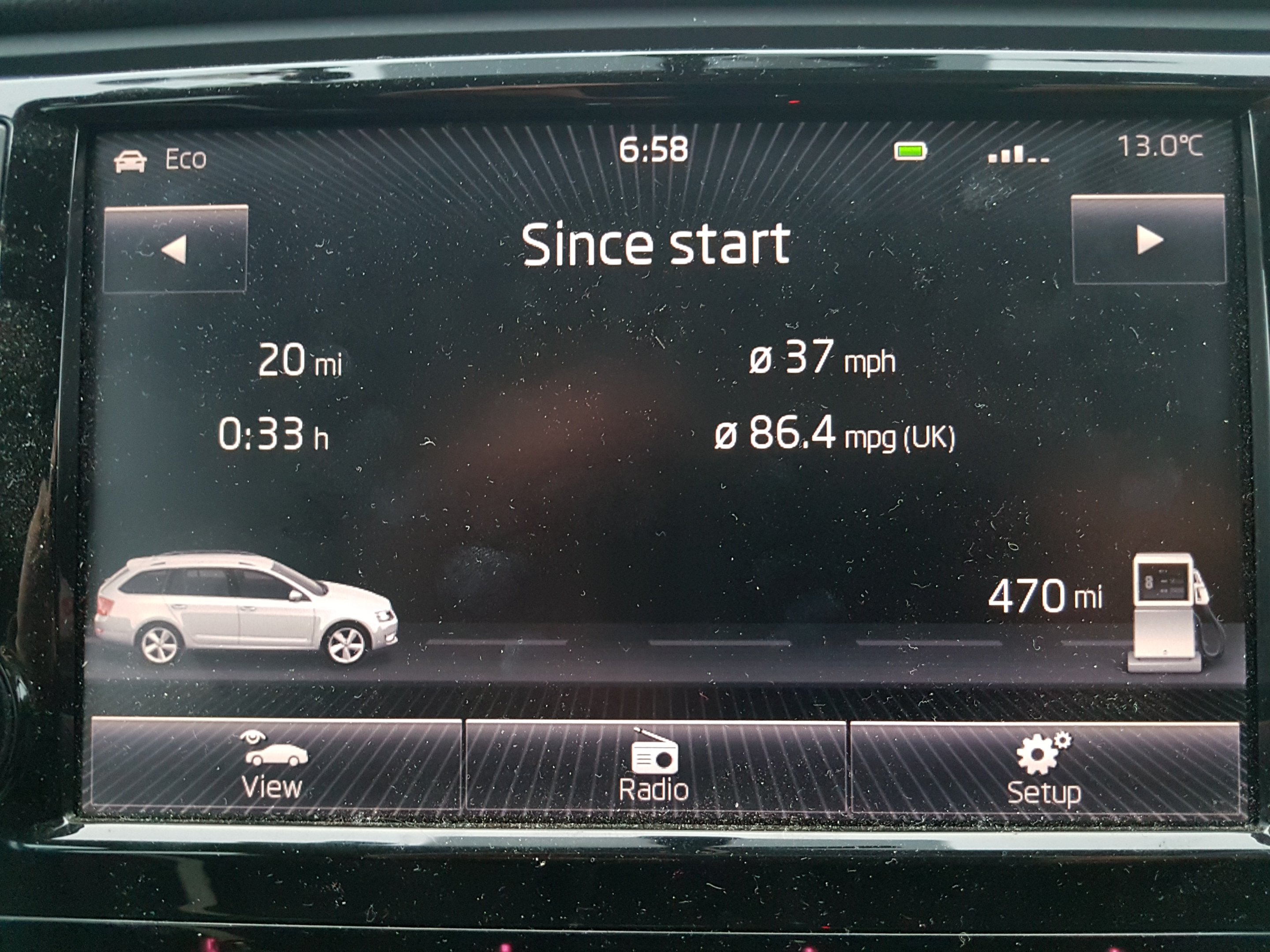

I'm a bit of an MPG nerd and have frequently got 80+ mpg (indicated) out of my Greenline over the past year on my 20 mile commute (max was 90.3!!). This is backed-up by on-going full-to-full calculations giving me around 70MPG average - this includes school runs and my wife driving etc.
I'm not looking for yet another debate about possible MPG vs manufacturer's etc.
But since coming back off holiday (with the car being parked for 2 weeks) the MPG is noticeably and consistently lower - in all circumstances. I'm struggling to get 70mpg on my commute....
Does anyone know what might be causing this?

Thanks all for your comments/suggestions. Several weeks on and it does appear that Alex-W was probably the closest.... I think I had effectively forgotten how to get the v high mpg out of it after 2 weeks of driving a hire car!!
Reasonable but slow acceleration. Loads of anticipation. Carrying speed (when safe) through junctions. Windows closed. Good tyre pressures. Right gear. Cruising 50 - 60 mph. etc. etc. etc.
These all help but the real trick is;
Once you get to the speed you want you momentarily lift-off completely and then touch the accelerator as lightly as you can to maintain speed - this changes cruising on the flat from 70-80mpg to 90-100mpg!
