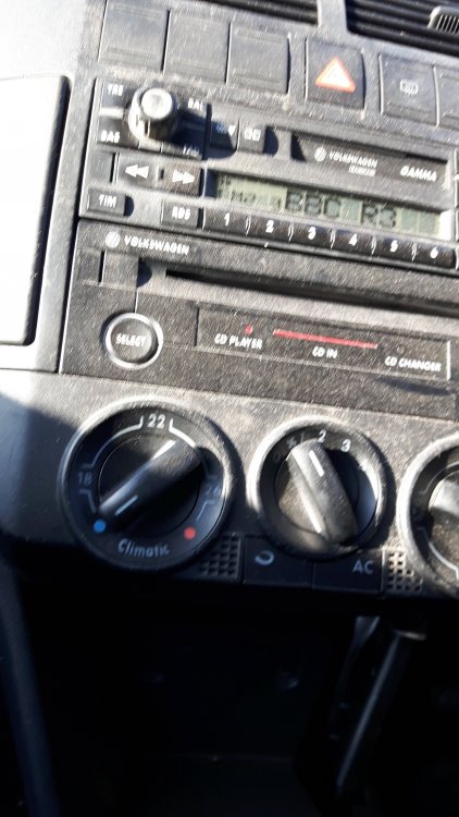

I had to chuckle on the way to work this morning, because when I looked down at the Climatic heater panel on my (2003) Polo, I noticed there are temperature markings on the dial.
Looking at an Owners Manual for a Mk1 Fabia, it appears on those too.  Doesn't your car have these numbers?
(Apologies for the extreme dirtiness of the dashboard!)

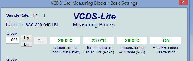

Indeed. Pretty sure you can see what G56 is measuring within one measuring block group, will have a look on my Polo shortly.
  • Sponsor
Two vent temp sensors and one panel sensor, as well as the (not shown) evap temp and ambient temp.
Searching G191 in the Octy3 diagrams has no hits, G192 only within Climatronic diagrams, and G56 in both Climatic and Climatronic. So it does look like the Climatic system has been 'cheapened down' a bit since my car was made.
