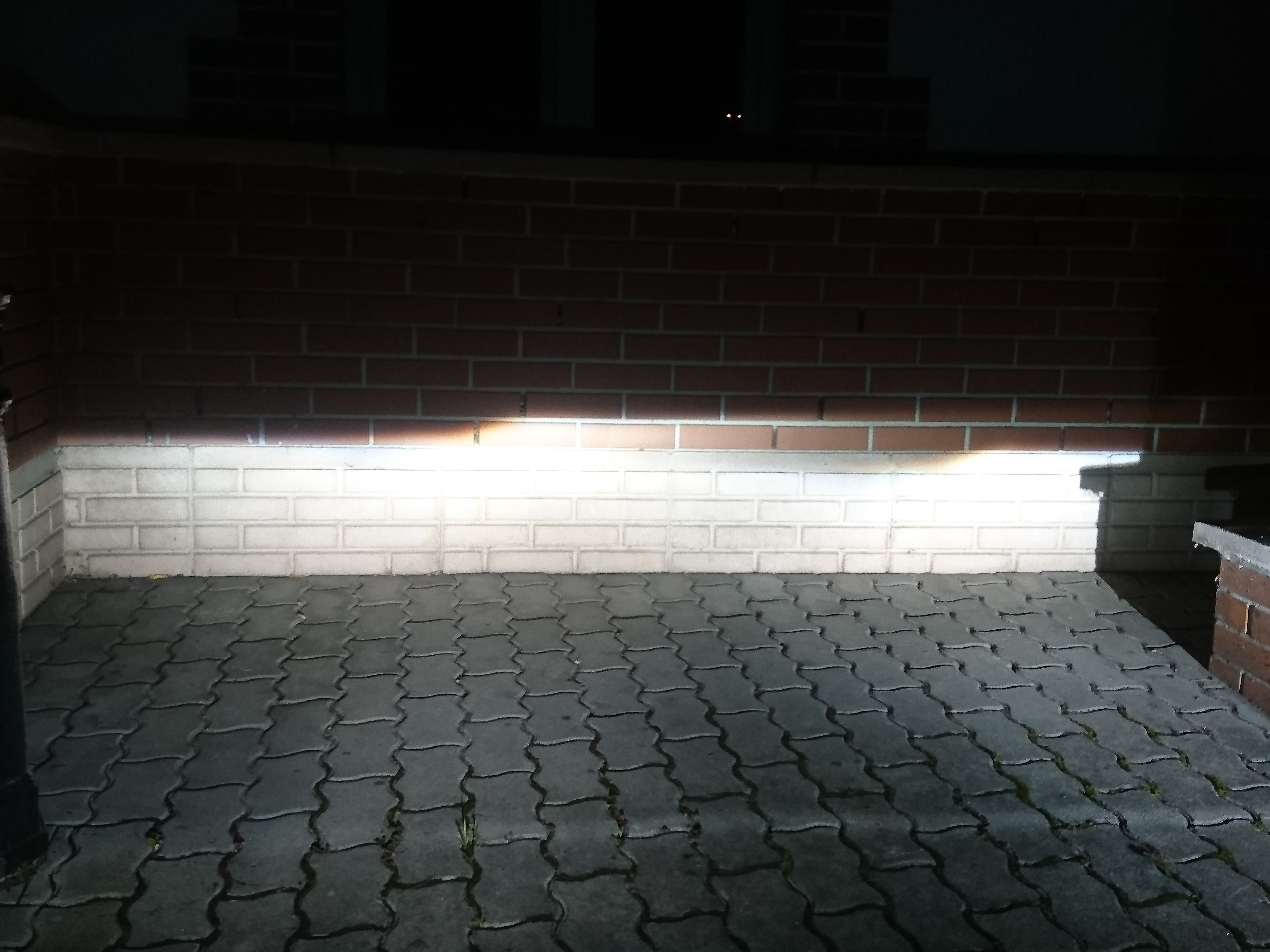

Hy i got Bi-xenons AFS lights but they are off with the lights i mean they are not pointing where they should be is there any VCDS tutorial how to alligne them properly?
I think the car got new lights and the service has faild to alligne them.

I turned the lights on manualy and after a short drive in mode selector to eco, i can confirm the afs wont do amything in those mods.its a bit better but i think it is still not as good as iz should be and I would like to use zhe afs. I must visit a service to straighten the steering wheel.here is a pic  iam driving on the right hand side of the road.
