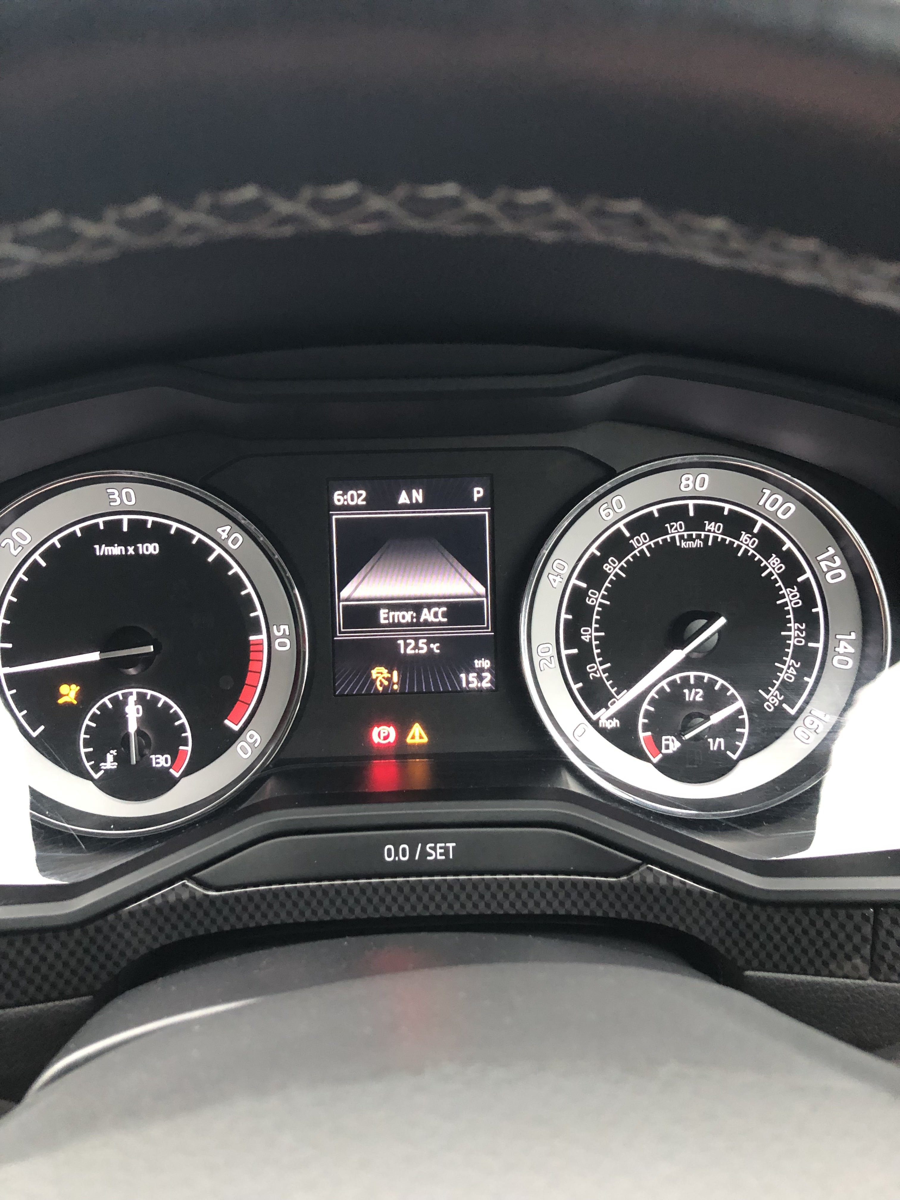

So, I spent most of the afternoon hard waring a dashcam to my 4-day old (used) Skoda Superb Mk3 Sportline 2017 plate.
I spent loads of time hiding all the cables, even threaded the rear cam cable though the boat gator, tidy job. I had identified 2 fuses to piggy back on (perm. live and ignition live) (both 5 amp) Fuse 5 - Databus and Fuse 16 - phonebox. Did a test drive before did the permanent wire up to make sure that stop start didn’t power off the cam - all good.

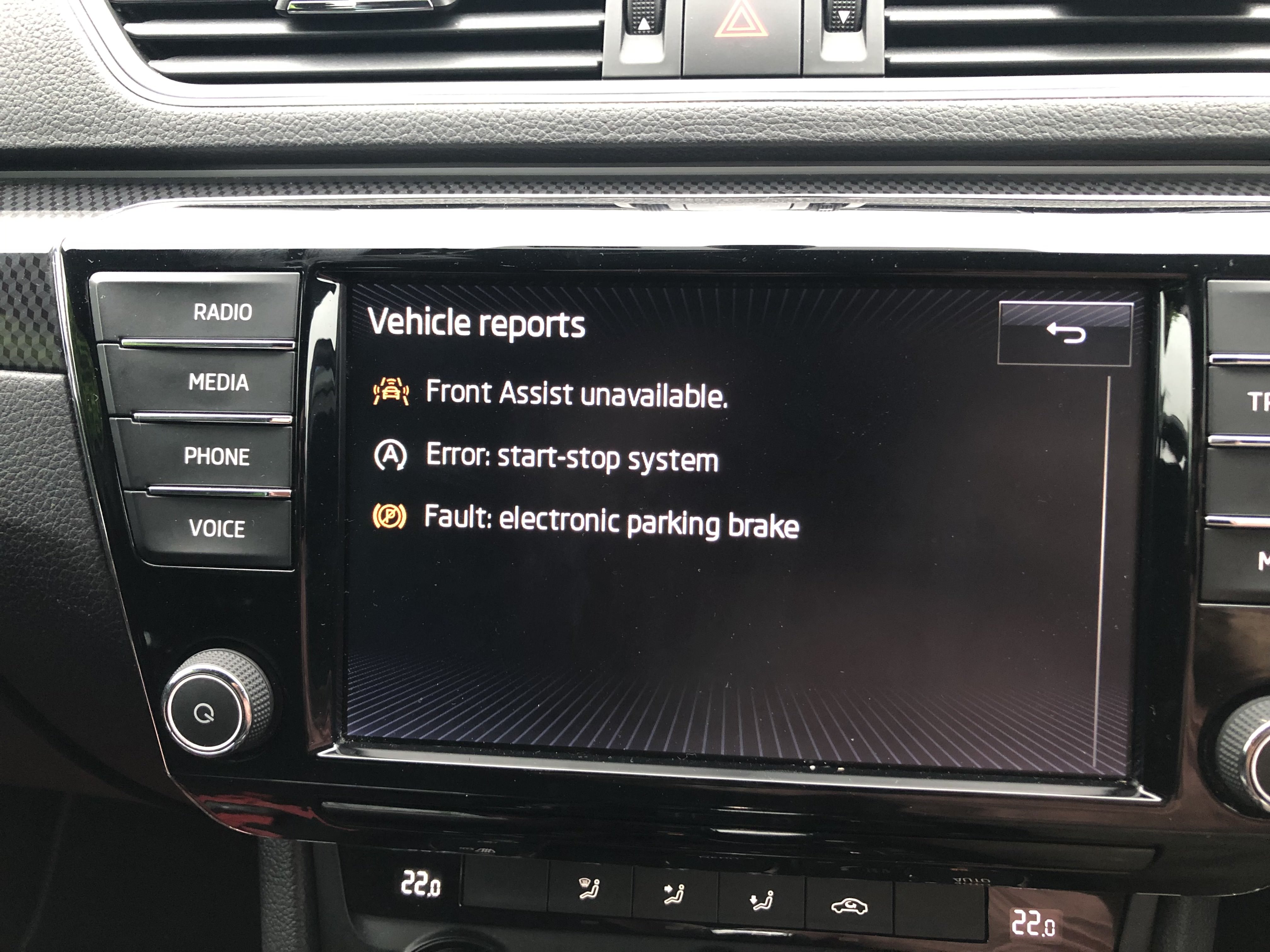

I had the fuses out of fuse 5 and 16 for some time while I routed the cables, replacing them to start the ignition, only to find an errors and faults - Adaptive Cruse Control, unavailable, stop/start unavailable and front assist unavailable and bizarrely a fault on the electronic parking brake.
I thought I must have blown a fuse – so I tested continuity on all fuses and the ones in the engine bay – all good. I double checked everything. Removed the piggy back fuses … same errors. Took the car for a long spin and reset to factory default. Same errors.
Anyone got an idea? – searching the forums it sounds like a recalibration, but any pointers would help me before I ring Skoda.

It feels rather odd that those systems would have all an issue. Could disconnecting the databus somehow have reset it? or caused it to loose some settings?
If there is a fault with the parking brake would that cause the other systems to stop?
Would a detailed diagnostic(VCDS) give me more than my WiFi OBD?
Worth mentioning I had a reverse cam fitted by the dealer and coded. Could that have had its coding cleared and thats whats causing the error?

Out of the myriad of fuse locations to chose from, u had to pick the Databus one!!!!
Everything (all the electrics) in the car communicate via the databus.
Did u read the various dashcam installs in this forum?
I don't believe anyone has used the same fuse locations that u used.
Why did u pick those ones?

agree, if you disconnect the databus one you'll probably need to have a dealer reset the software- may be possible if you disconnect the battery?
Bear in mind modern car electronics are never completely off.
You don't need to choose one the same rating as the camera. Lots of threads on here about which fuses to pull

Just a thought, did you leave doors open for a long while when fitting? You can get strange faults popping up if the battery was in a low state of charge when you fired up
Edited by bigjohn
@bigjohn - Yes - I had them open while removing the seals and routing the wires.
Then on starting it did turn over 2-3 times before starting
I did notice at one point it said imbilizer enabled.
The car ran ok yesterday - obviously still with these errors. On MySkoda the battery readout is 13.4v

I spoke to Skoda. They suggested disconnecting the battery for 10 mins - (negative lead only)
Unfortunatly that didnt do anything - although im not sure it fully reset the car becuase some of my preferences were retained.

On my old Octavia I used to have to leave it 30mins to clear any faults. How about getting the Carista device /app?

Yup, the low voltage confuses things. Now voltage etc is normal you'll need to clear codes (they may clear eventually after the car has been started a few times)
Find someone with VCDS around Crewe.
