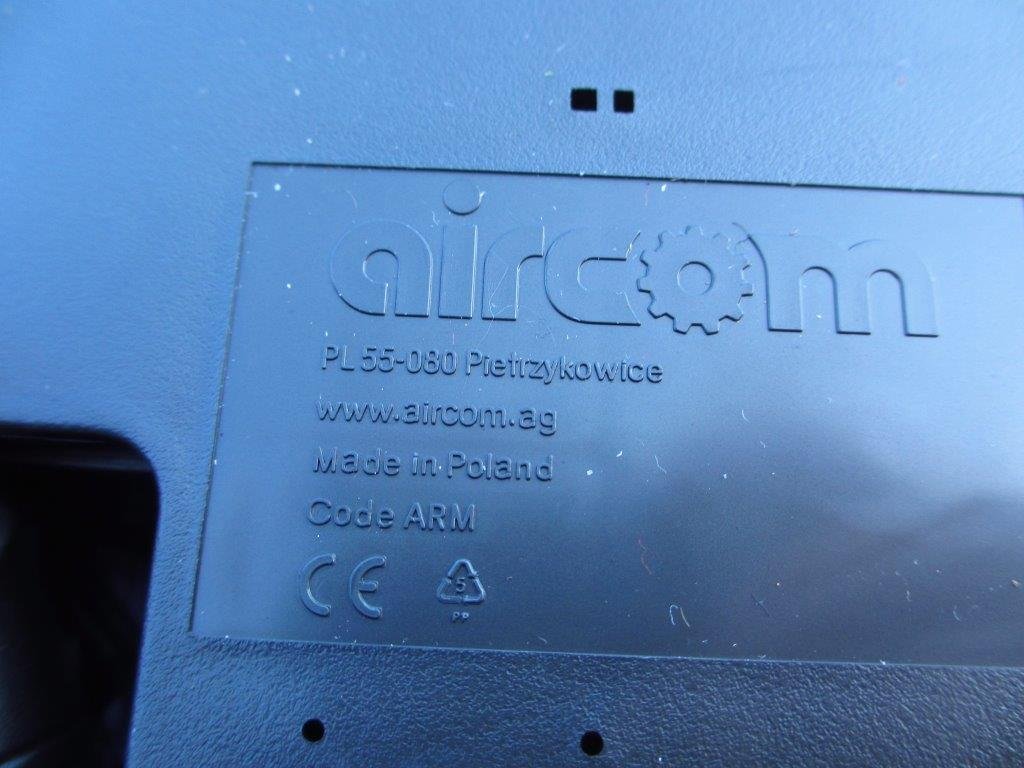

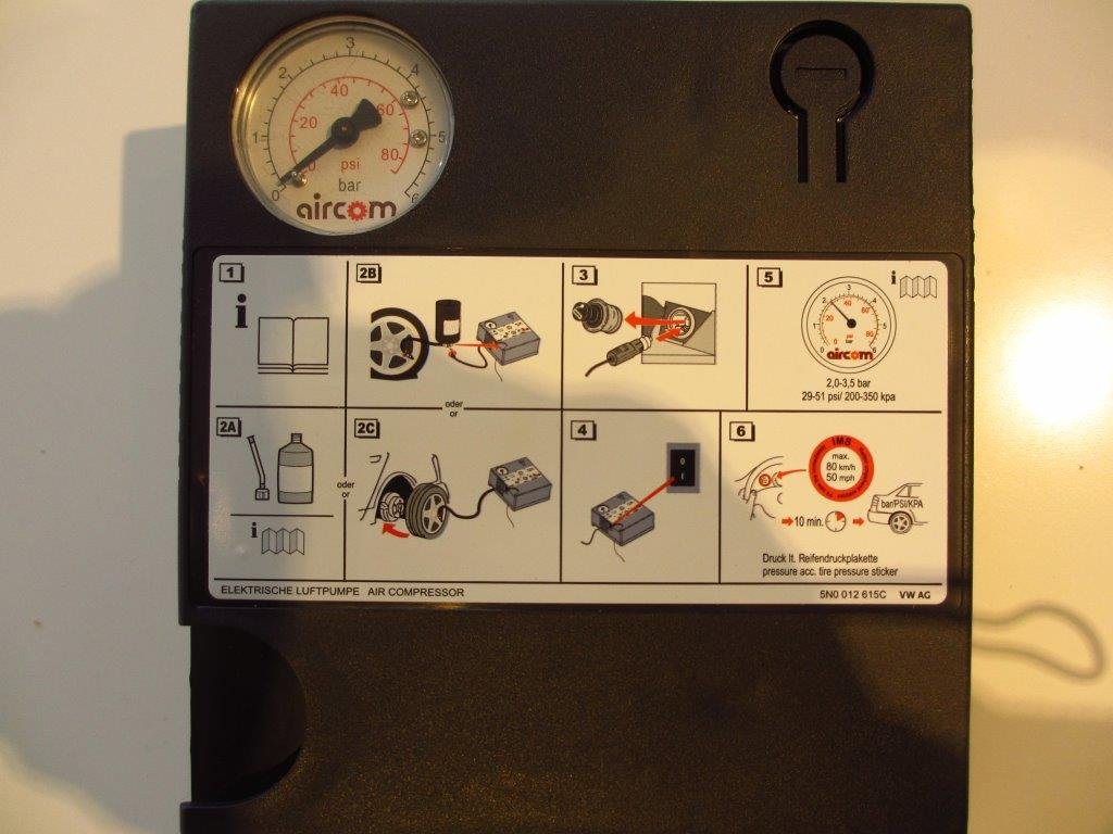

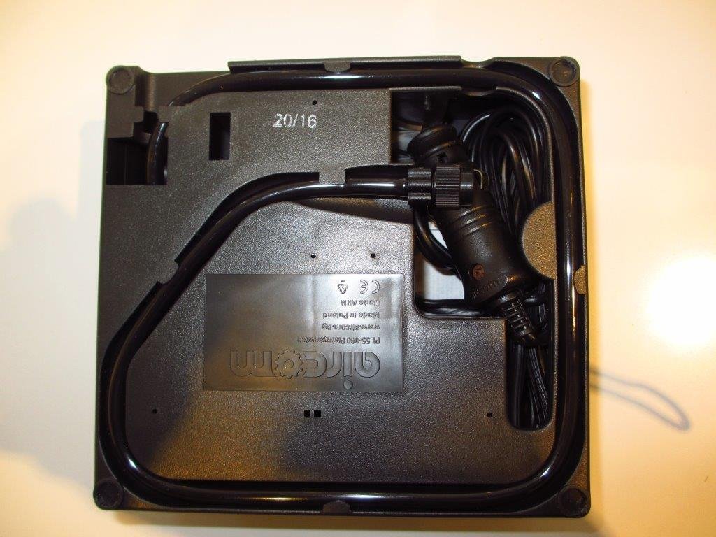

Hi all
I've got the pump that was included in my 2016 Superb. I've tested it by plugging it into the boot 12V socket (engine not running). Turned pump on and it ran fine. Covered nozzle with my finger (inside a thick rubber glove) and the pressure went up immediately to 30+ psi. No overload, no fuses blowing. Repeated it with nozzle covered before switching on and same result. Didn't have a current meter.
The pictures show the details of the pump.  Hope this helps.

I have a hunch that there is still something a miss here yet to be found out. Is your pump(s) the same as retiredbri's one above?
retiredbri:
Yep that looks pretty much like the emergency pump that's usually supplied within VAG. I assume you have the foam canister Included in your emergency kit as well?
