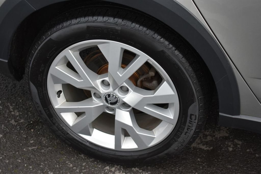

It's the 150 BHP version and currently on 17" alloys (the ones in the photo) so fairly low profile but not the rubber band variety.  18"s are a Skoda option but I'd sooner go smaller rim, larger aspect tyre.  I understand the bit about brake system clearance, I fell foul of it once many years ago.  Nice set of smaller diameter rims, wouldn't go over the calipers (bother!) and exactly what I'm trying to avoid now.

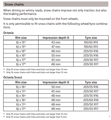

There is a list of wheel sizes in the manual, along with whether or not they can be used with snow chains, this might answer your question.
I am going to test fit my 9mm snow chains bought for my previous car, even though Skoda does say my wheels aren't suitable (6.5Jx16, ET46), in case I need to be out of a hole in an emergency.
Thanks, micro.
Taking delivery tomorrow  😁, so there's obviously a lot of reading to be had in that handbook.
