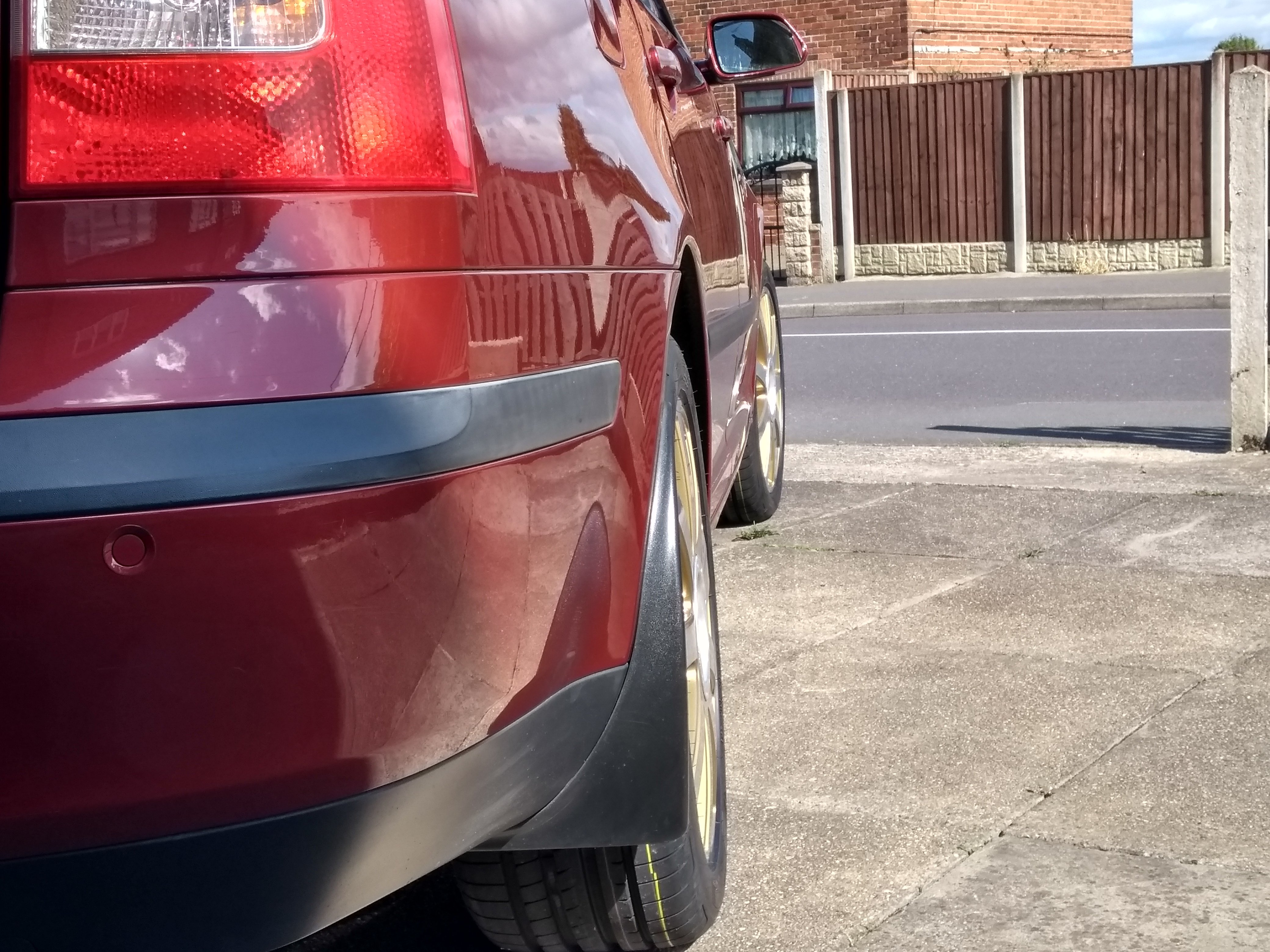

I've had 15mm spacers fitted on the rears for 35k miles no issues with bearings ect. Agree with all the above, adds nothing but aesthetics (which is why I added them)

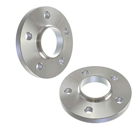

i had 12mm hubcentric spacers on the rear of my 2011 mk2 Octavia RS for 6 years - no issues.
i now have 15mm hubcentric spacers on the front & rear of my 2017 mk3 Superb 220.  been 12 months now - no issues.
