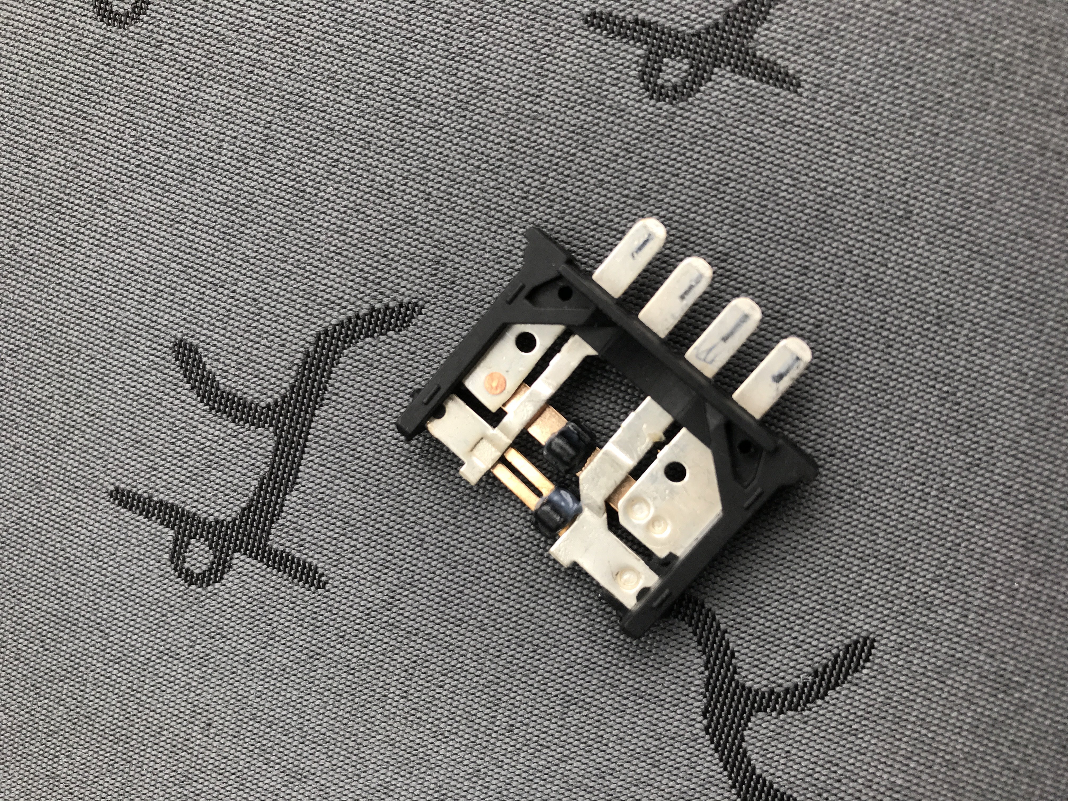

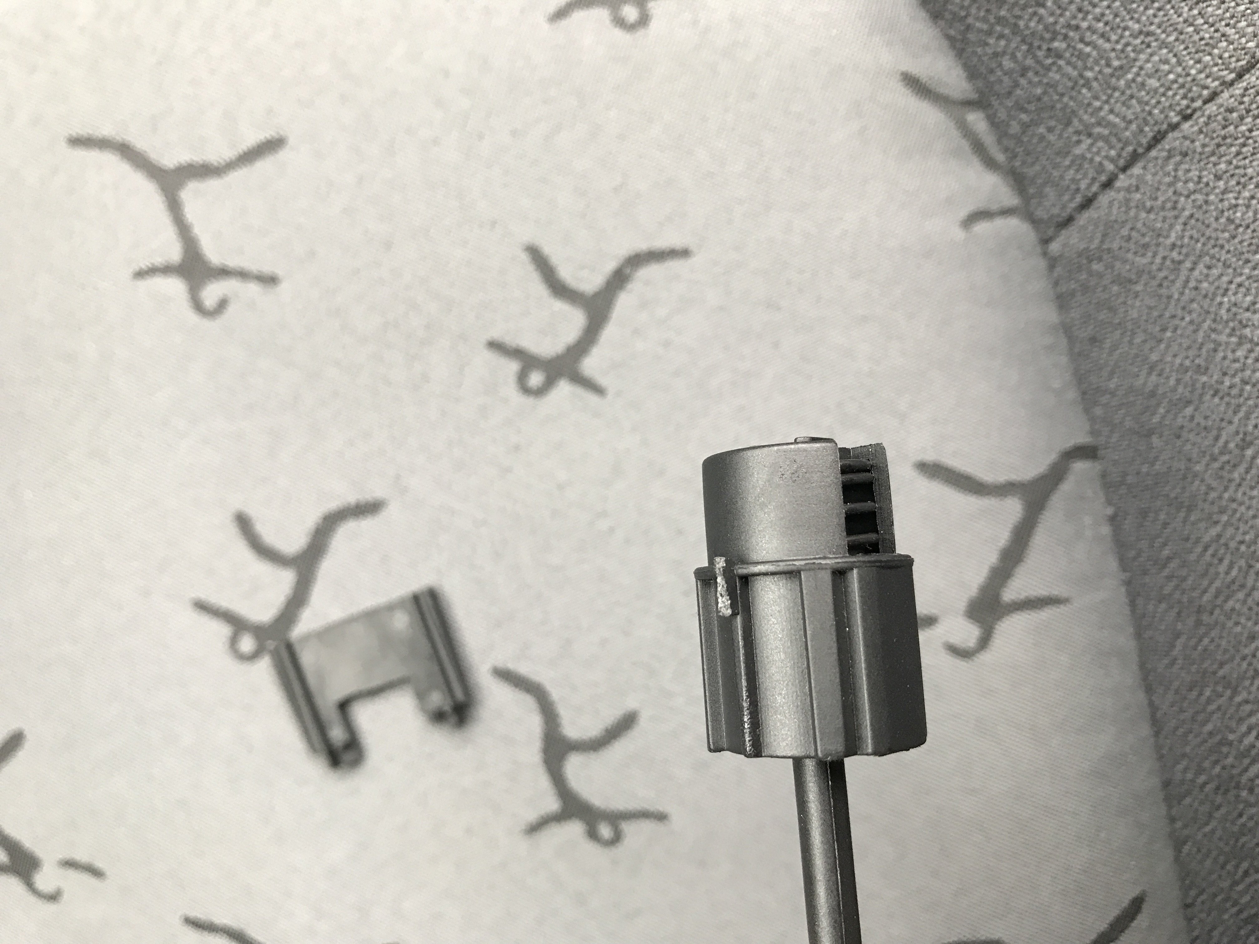

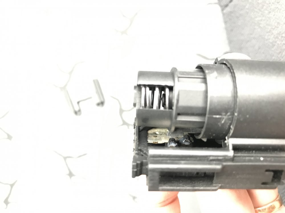

I had exactly the same problem on a car I just bought. Dead battery from messing with the wiring and all.
Some of the brake switches are really junk, I took two apart (broken original and ebay replacement that arrived broken) and there's this tiny bit of plastic that triggers a blob of glue to break the circuit, the plastic is really weak and brittle, and this bit on both of mine was broken. I fixed one with some of that epoxy stuff, but also  bought the boxy square looking one, as apposed to the (cheaper) more cylindrical looking ones and the boxy ones (or at least the one I bought) seems a better quality.
Unhooked the battery for 10 mins, cleared codes, and everything is better now.
Crazy how much trouble this bloody switch can causes, especially on autos.
Just switched to my phone to put these too so you can see what I’m talking about
