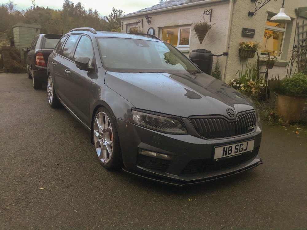

I am running H&R 40mm lowering springs. My car is a vRS so it’s 25mm lower than a standard vRS. Looks just right IMO.

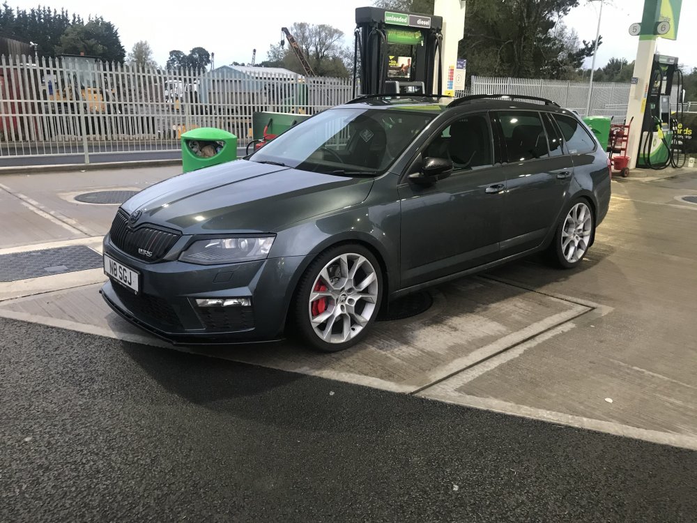

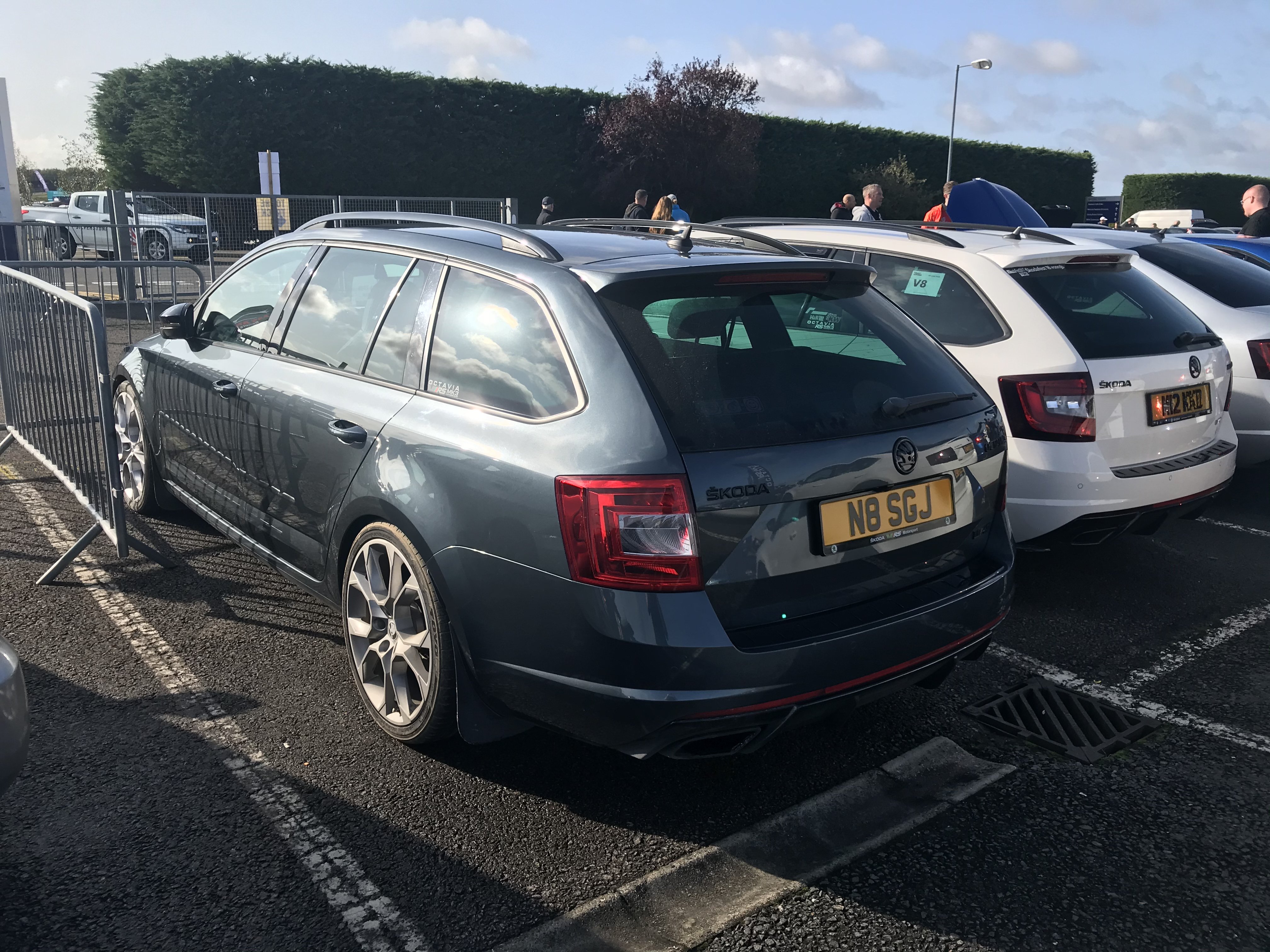

A little late to the thread but here’s an Octavia on B12 pro kit. Essentially the B8 + Eibach pro lowering springs. The rims are 18”.
