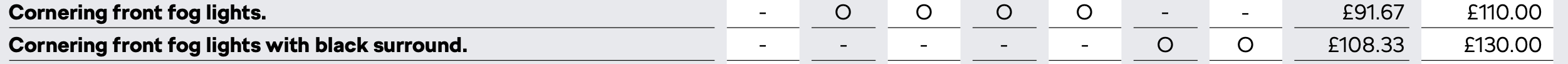

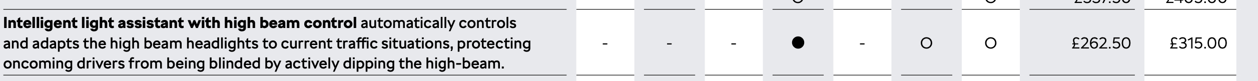

Most, if not all of the Items you have had enabled are paid options from the factory,
Thats why they arn't standard, surprisingly people actually order these Items
Edited by Auric Goldfinger
6 minutes ago, Auric Goldfinger said:
Most, if not all of the Items you have had enabled are paid options from the factory, can't remember the exact prices but Cornering fogs is about £200, High bead assist £150, the list goes on.
That is absolutely bonkers...
Maybe I'm spoilt, I've just come from owning a 2018 Honda Civic sport which had all these things as standard!
The Honda had terrible build quality though!
Much prefer my VRS!
