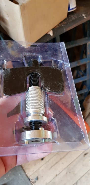

When changing my rear pads. Ive wound the piston back as far as it appears to go. I used a winder tool for this. But cant get fit the caliper back on with the new pads and shims in place. The caliber is  winding back but not far enough.

The fluid won't be stopping it as the system isn't sealed. What wind back tool as you using?

Isn't it clockwise on one side and anti-clockwise on another?
No, clockwise on both.
Its a clockwise tool. Amtech. Pic attached.
How far has the piston gone back?
I'd say its goes back to about 5 or 8mm from flush with the housing. Its all reassembled now so I cant measure exactly. Should it go back flush?
