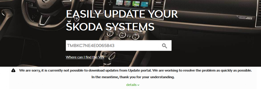

I went to the Skoda Sat Nav site (http://updateportal.skoda-auto.com/en-GB/Updates) today to update my cars maps as they haven't been updated for about a year.
When I entered my cars VIN I got the message :
There are no map and software updates available for this VIN. Please contact your local retailer for more information.
I would expect a list of the latest Maps update.
Does this mean my SatNav is no longer supported?
It's not working for any of us. There is an error message you must have missed, look:
Thanks seen it now.
