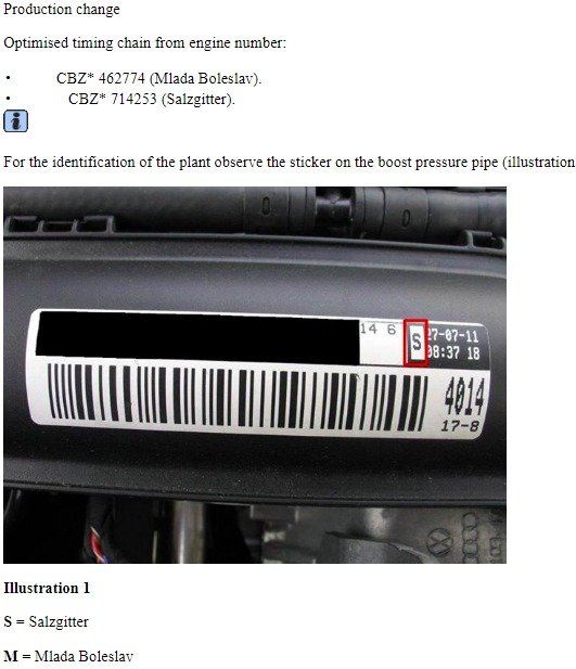

Hi, looking for the engine number and plant from the sticker shown below on the boost pressure pipe , but it is not present on the vehicle. Is there another place it will be listed?
I have the engine number but not sure of the manufacturing plant (for the engine). Trying to get to the bottom of any potential timing chain issues. The vehicle is on a 61 plate (registered in UK Sep 2011 to March 2012. Engine is 1.2TSI. Engine code from paperwork is CBZ541551
Or should I say that this is the engine number that has been given by the seller.

You might find something on the build data sticker in the boot, which there may be a copy of in the service book?
