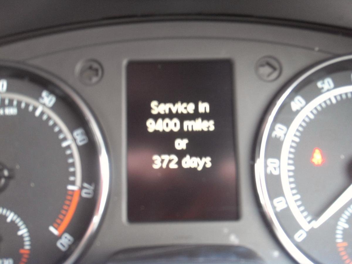

Reset some Service Indicators on Skoda Models in the UK and on Fixed Service and they can show 9,400 or 9,600 miles / 372 days.
Check the likes of DSG OIl Services on a VW, SEAT, SKODA and they might show as 40,000 miles and for s-tronics on Audis 38,000 miles.
http://volkswagen.co.uk/owners/servicing/regimes
Re Maximum Variable / Flexible Servicing,
All good and well @ 18,000-18,500 miles the cars shows Oil Service required, then Skoda, SEAT, VW, Audi main dealer can not get you in for a month and the Oil-Filter change gets done at over 20,000 miles.  'Not unusual'.   FMDSH though.....
Edited by Roottootemoot
