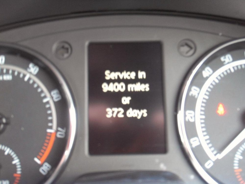

You are correct all leave the factory on variable, but if you then read the book it says variable is for high mileage drivers only. Variable not suitable for town driving, lots of short journeys, towing, hilly areas

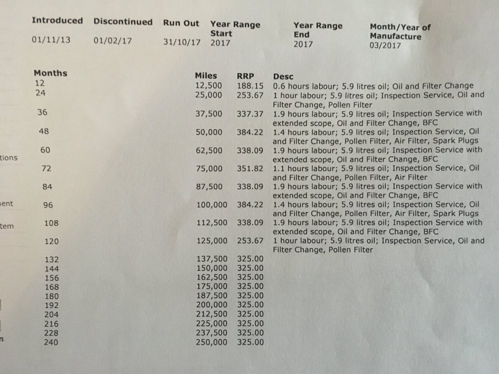

I believe for variable service, you need to do inspection at year 1 but a major service every 2nd year (if variable doesn't warn you to do it sooner). In another words, every proper service (if we ignore inspection for now) is a major service.
So the 2 yr service plan is actually a con IMO. It doesn't include the correct service requirement of the car.

Regarding your Service Plan comment: the Skoda GB web site does state that the 2 year Service Plan meets the manufacturer service requirements.
For cars up to 1 year old, the service plan is a basic oil change at 10,000 miles/1 year and an oil change at 20,000 miles/2 years. So it appears to be similar to a Variable service at 20,000 miles/2 years with an additional oil change at 1 year. If the car is older than one year, the 2 year Service Plan is basically 2 standard services: one Inspection and one Major. So I assume that they work on the basis that nothing much is going to need attention/maintenance in the first couple of years.

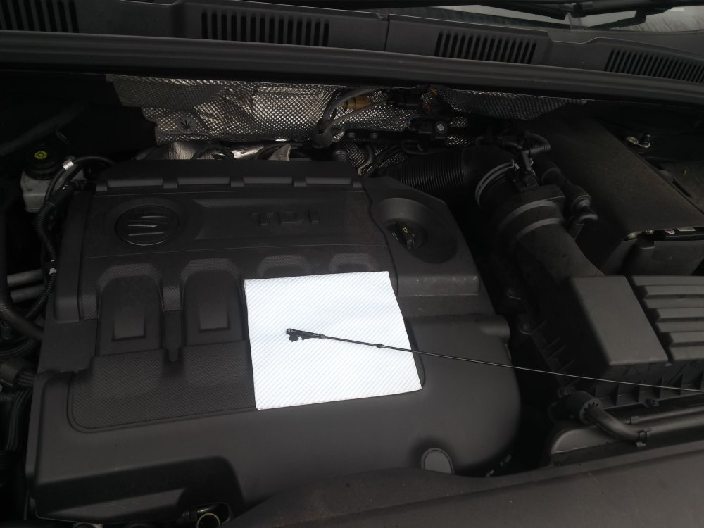

To be honest, if you open the bonnet, and check the oil on dipstick, just by looking at it, will give you a much better idea than looking at a computerised guess

Sounds like you're confused. What SurreyJohn said ( Variable not suitable for town driving, lots of short journeys, towing, hilly areas ) is spot on.
1: Absolutely not. Variable does not monitor the type of driving. What happens is a degregation sensor monitors the quality of oil and requests a service when the oil falls below a set parameter. Servicing is also more than an oil change.
2: Your logic is wrong. It's not that you travel 5k a year which consists of a 9 mile commute, it's how you drive the car and the conditions it's driven under that's the determining factor for servicing.
