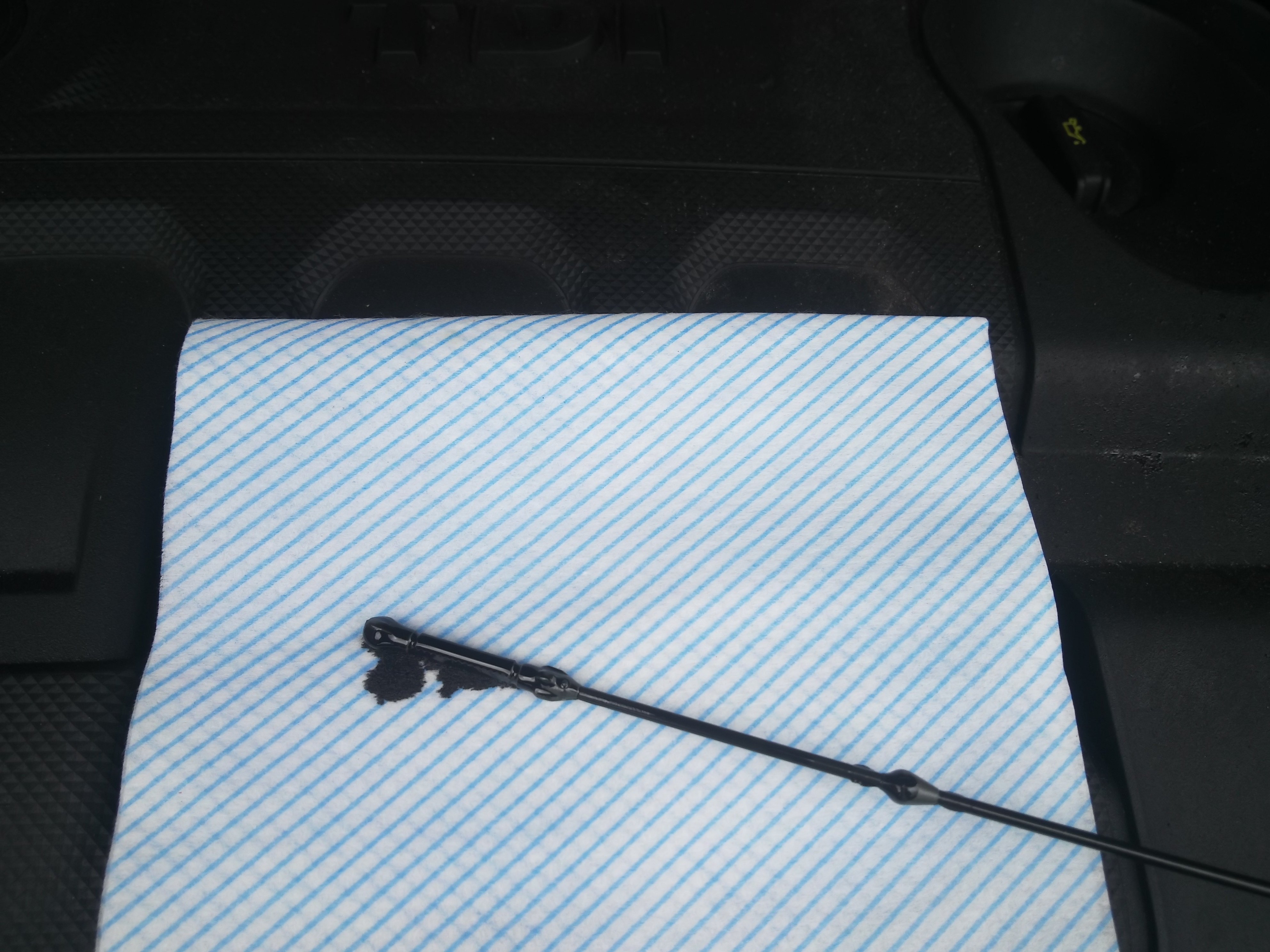

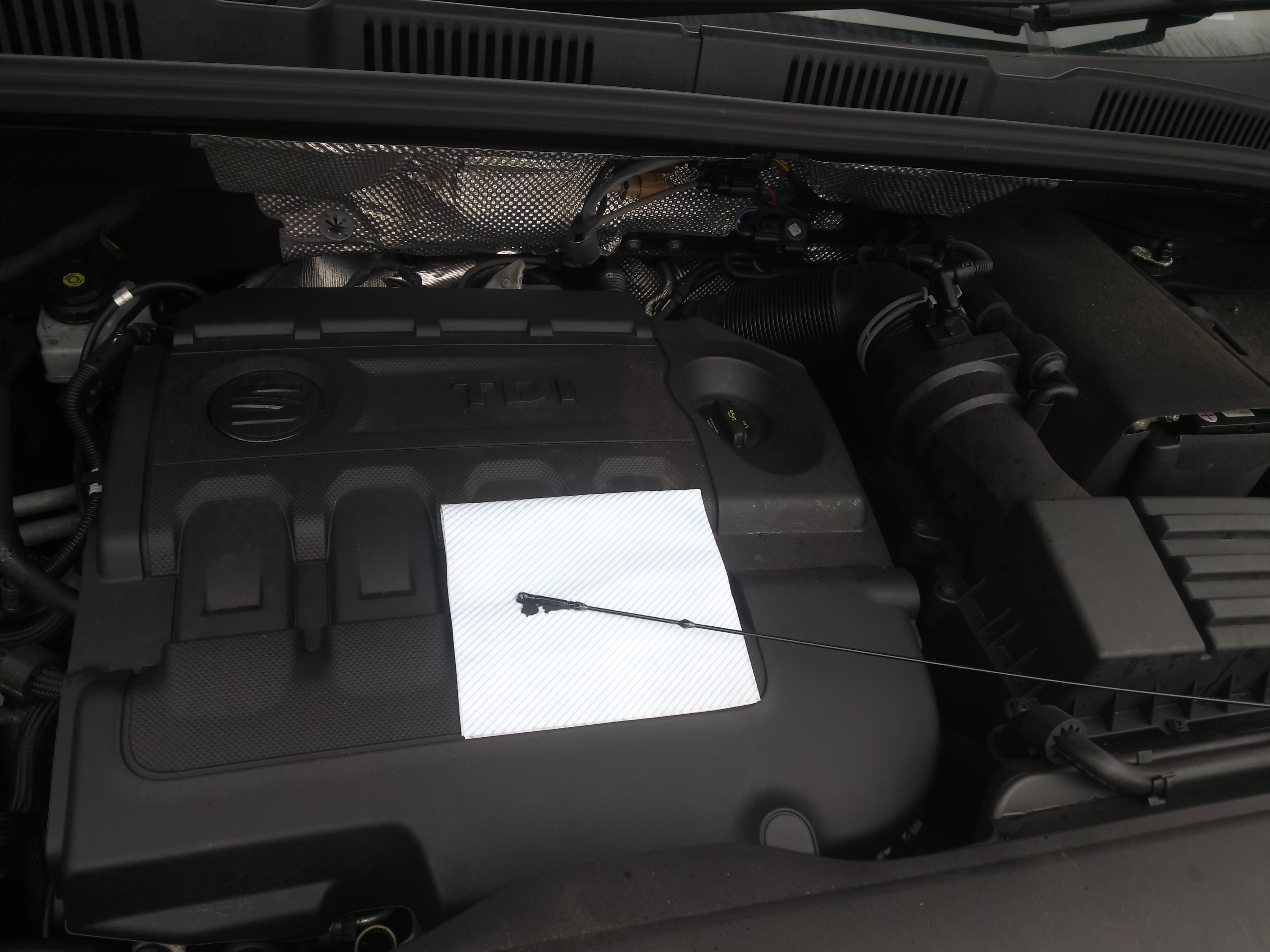

My car has been MOT'd 2 months before due not just a month early.
Advisory on the Windscreen wipers torn, Skoda / Seat dealership staff that did the MOT & brake fluid change but no service said they had no wiper blades, come back in sometime.
The worn front tyres that were just an advisory will still be on when the car goes back in mid November unless Kwikfit approve replacing.
The car will have done 3,000 miles since the MOT before getting to BCA.
2 Major / Flexible service intervals, but at the first one even though it used oil over the 19,000 plus miles & had 2 litres of topping up it was clarty, not just diesel / TDI dirty.  Like Clotted cream and by the time the SEAT / Skoda dealer could have it in for the service it was over 20,000 miles on the factory oil and top ups.
Never raced or rallied, just some spirited driving.
Personally i would not want to touch it out of warranty with someone elses barge pole.
Needs the DSG Service doing, Discs and Pads, Tyres, wiper blades & 3 years old.
& It will be a British Car Auctions in a month with FMDSH.

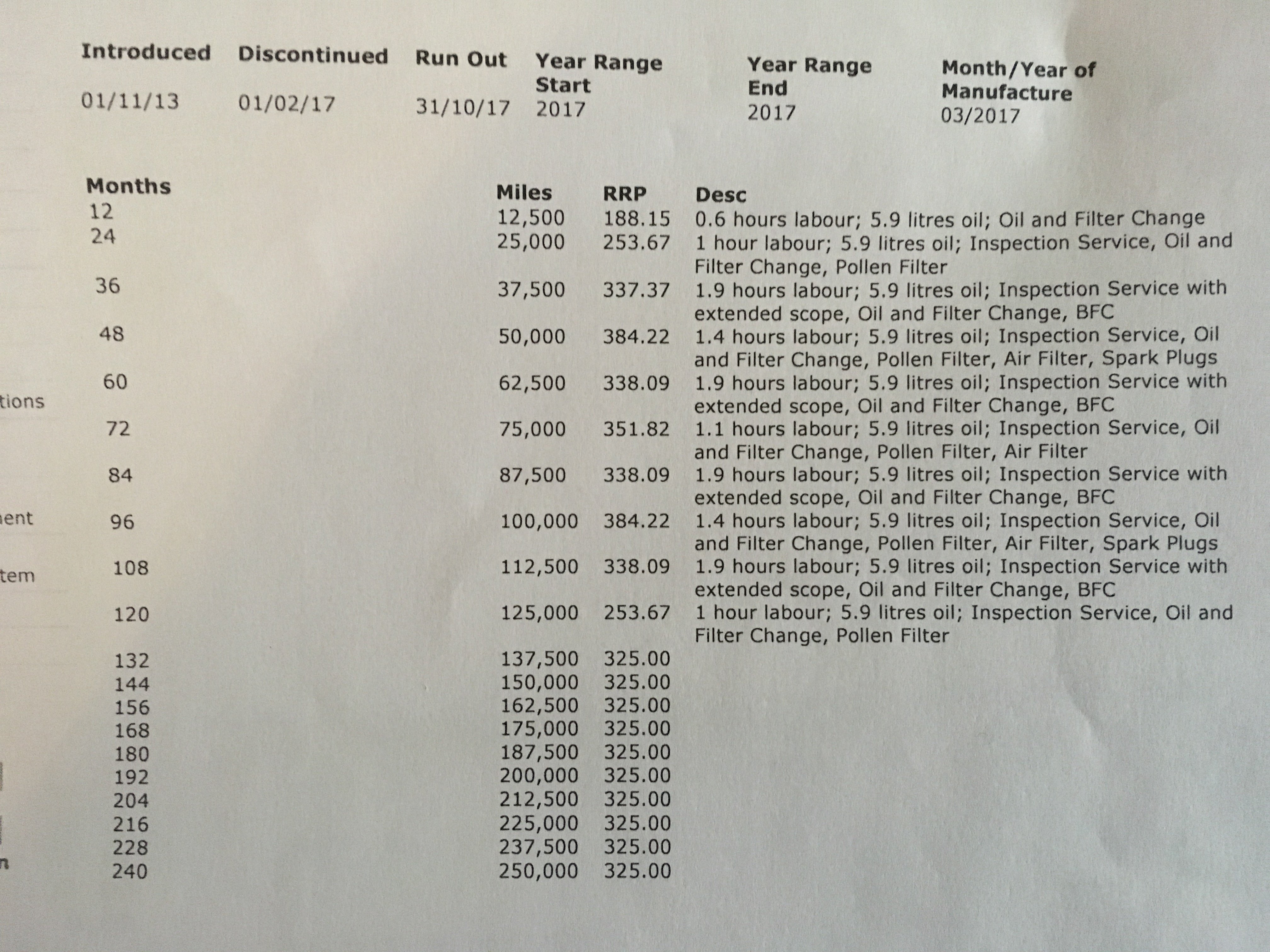

Just had my Petrol, manual, 2017 VRS in for its second variable service at 37600. First service was a “minor” and this one was a “major”.
I asked for clarification on what work was to be carried out, as from the Skoda Uk website, as we know, it states “spark plugs, fuel/air filter as necessary”. Service manger went onto “the computer” to say it doesn’t need any of those but we’ll still be charging you the major service and a brake fluid change. I asked him to print out the screen he’s working from as regards what needs changing on my car when. Here it is attached.
Since studying it, it becomes apparent that it is a nonsense. My car on variable will next tell me it needs a service at approx 55000 miles, yet at 50000 miles it should have spark plugs etc.
If I’d had it on fixed 10000 miles, then I would take it to the dealer and they should say they’ll do nothing until 12500! The next service is due at 25000, which even basic maths tells me is not divisible by 10! So when would it be serviced.
As regards my current mileage 37600, I paid for a major, had none of the parts changed, the car thinks it can go to 55000, but should go to the garage at 50000 to have spark plugs and filters that I’ll have to pay for even though I didn’t get them at 37600!

'Inspection Service with extended scope', More labour time than the next service where the spark plugs and filter will be changed.
What was the 'Extended Scope of the Inspection Service' actually?
Recommended Service Schedule was and is,
Spark Plugs due at 2nd major service, and that does not mean 40,000 miles or 4 years. but for some that will be when due.
Robbing Barsteward should have your car back in and the spark plugs supplied and changed.
Has the Air Filter been looked at to see if it needs replaced.
That would be a basic part of a Major Service, eve a Minor / Inspection service. They are taking the pith.
