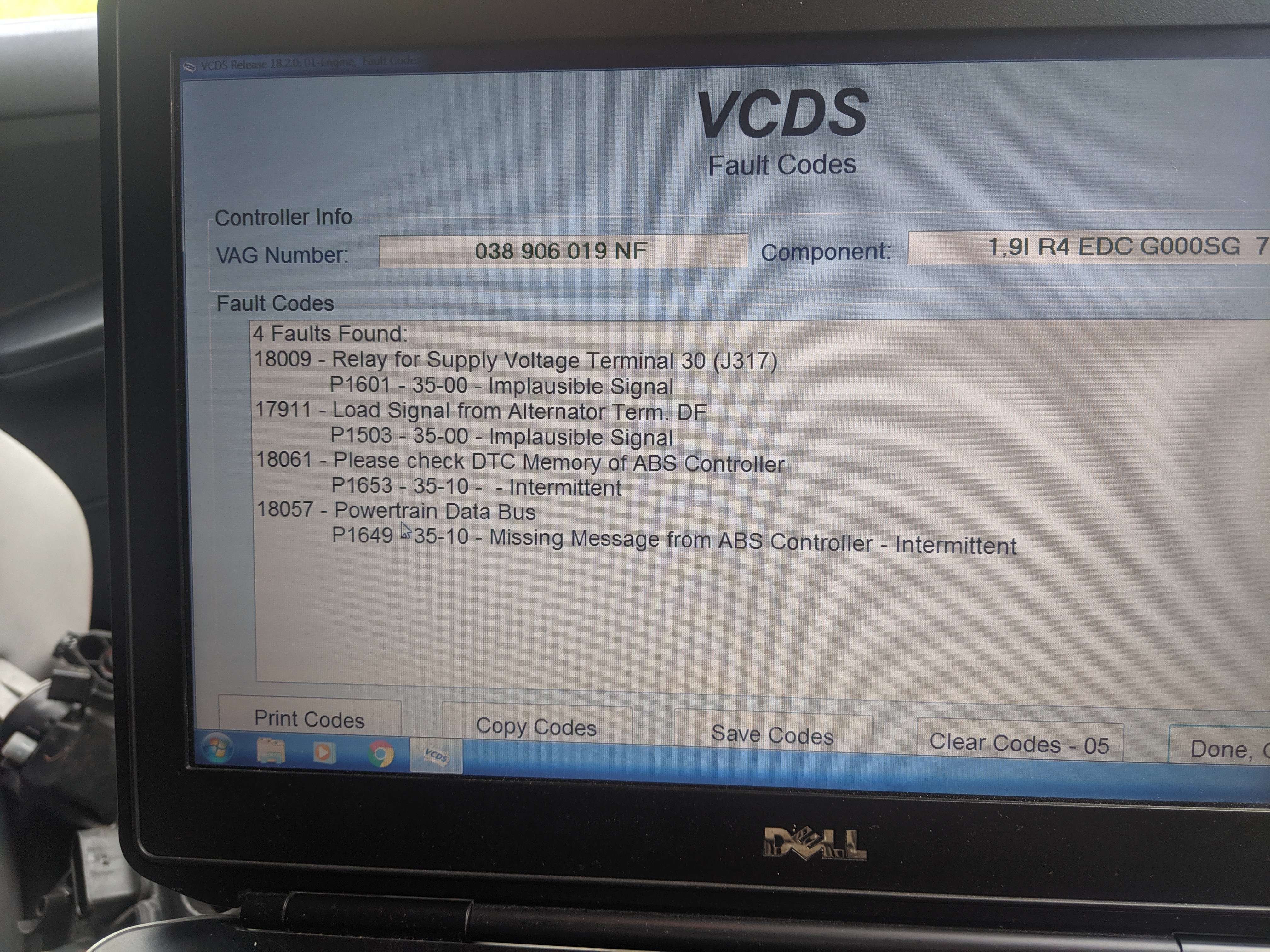

ABS/traction control seems to have stopped working have engine warning light traction control abs and flashing handbrake light with beeping. Have replaced the abs unit but has not sorted the issue. don't seem to have any communication with the abs module using the vagcom. Have checked the fuse links on the battery and the fuse in the box next to the steering wheel. Also checked the power and seems to be getting the volts and the earth to the plug for the abs module. Any more suggestions would be much appreciated.

Maybe keep fixing it until the 17911 code stops appearing? Have you tried clearing it?
Yes just left with the 18061 and 18057

In that case I'd be carefully examining the pins of the ABS module connector (both module ones and loom connector ones), then if everything there looks clean and dry, head back up the loom looking for damaged wires, Looks like CAN wiring might be favourites for being involved, and they are generally a twisted pair which may make them easier to trace.
Getting the correct voltage on the 2 power and the 2 ground seem ok also. There is 60 ohms resistance between the twisted pair.
