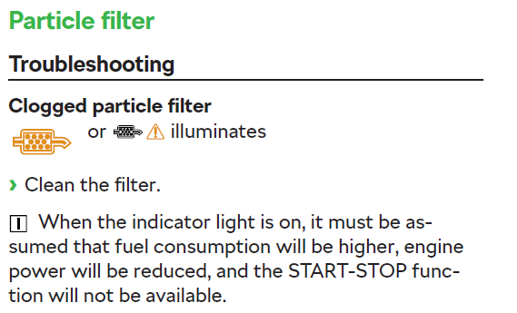

On 20/10/2019 at 09:28, Gmac983 said:
If you are aware that the car is attempting a regen on the dpf, then perhaps as an aid you should run the car in the described method in the dpf section of your handbook e.g. elevated engine revs in a lower gear above certain speeds.
You only really need to do that if the DPF light comes on - per the extract from the manual posted by silver1011 above, in fact.
There's no need to do anything simply because you become aware that an active regen is in progress while you're driving.  (I must have noticed it happening about three times in the nine+ years I've been driving diesel Yetis - plus a half dozen or so times when I've noticed the fans running on when I've parked up.  On each occasion I just thought "Oh, I know what's going on", and left it to get on with its thing.)  As silver1011 says, it's the car doing what it's supposed to do, which includes a process to deal with being interrupted every so often.  It's not a sign that anything is "wrong" as in malfunctioning, or needing help from the driver.  The warning light is provided in order to advise the driver when exceptional circumstances have arisen which do require intervention.  Absent the warning light, just get on and use the car.
