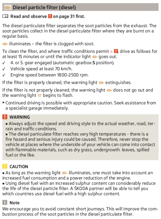

If you are aware that the car is attempting a regen on the dpf, then perhaps as an aid you should run the car in the described method in the dpf section of your handbook e.g. elevated engine revs in a lower gear above certain speeds.
as I quoted previously.  What I was saying is that the handbook does not tell you to do that unless the DPF light comes on.  It says nothing about "being aware that the car is attempting a regen".  Here is the only text from the 2017 edition of the owner's manual relating to the DPF:
722350284_Screenshot2019-10-22at11_22_40.thumb.png.31b065ed7a94152ea1c87955183a4c13.png
