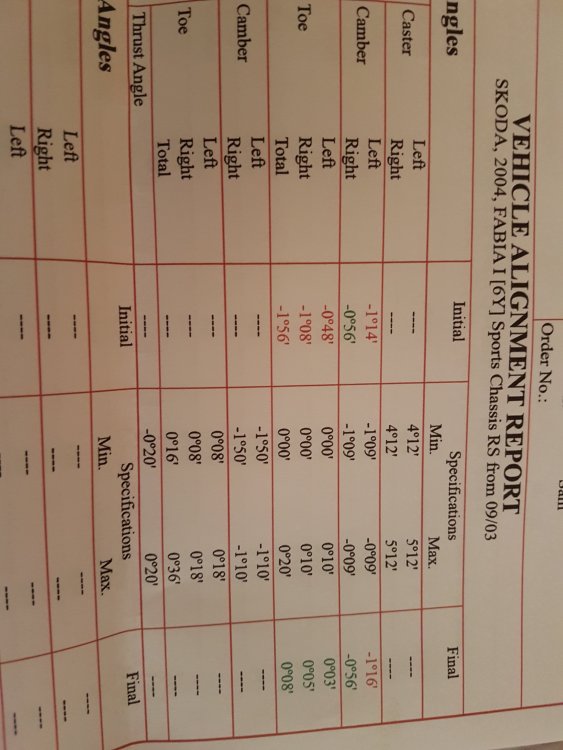

What are your current camber figures?
Initial.
Left 1.14 (red)
Right 0.56 (green)
Final
1.16 (red)
0.56(green)
This was on the 23/4/19 after having new suspension arms and new arb bushes. It was way out before this and the technician said at time that the left tyre would scrub on the inside after a while. Both have scrubbed badly on the inside and I can't understand why. The tyres where brand new at the time. (Toyo proxes t1r)

Presumably all those numbers have a minus sign in front of them on your printout? Can you scan or photograph the whole page?
In your first post you talk about wear on the outside edges, was that a typo?
It is possible to even up the camber by shifting the subframe across a tad, but there must be something else wrong I think.
Where did you get the alignment checked, somewhere like KwikFit who will happily measure but only adjust toeing?
As Wino said, why/how did they manage to adjust and correct the alignment and leave it the same as it was originally?
Are you using shortened springs, if so that will increase the camber a bit - and lead to you needing to buy adjustable bush assemblies.
So you have just over a degree negative camber on the n/s and just a fraction under a degree on the o/s.
That is just about ideal in combating the usual drainage camber on UK roads.

Sorry I meant to say the inner edges wore . I'll scan a picture of the hunter alignment

Update.....have found out that the garage I used in the past wasn't using a hunter.....they use a Hoffman. Always assumed they was using a hunter for some reason.
Car is booked in next week at the closest place to me that have a hunter rig.
Is a hunter superior to a Hoffman system ?
