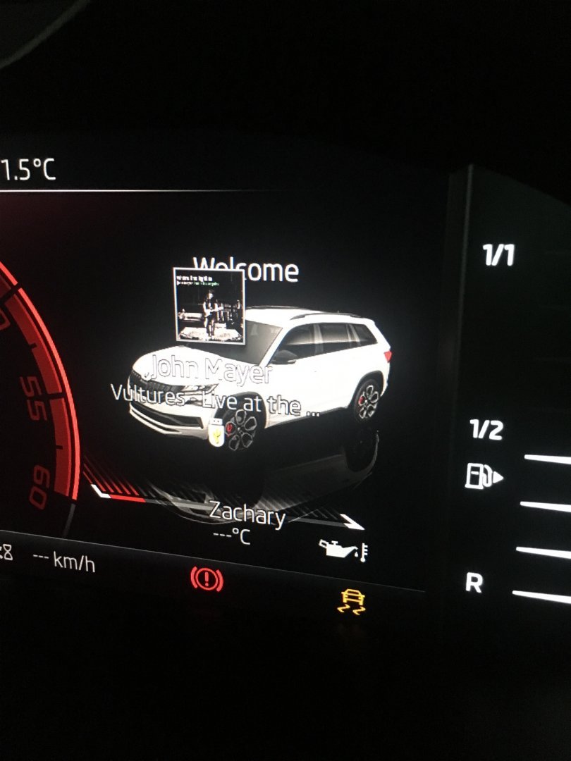

On 28/11/2019 at 23:28, ZacDaMan72 said:
My car does this when I start it up while in the sport view...not sure why? The information/oil temp display disappear with the confirmation button popping up, but just seems weird for it to show in the first place.
Do you have the same RS- white kodiaq and red brake calipers on the infotainment ? or when turning of the car?  I have a white RS but in this part only a standard white Kodiaq shows up. Gladly no issues as shown on the picture.
Mine's silver with different wheels from factory. You need to code the RS picture into the virtual cockpit, I can't remember what the coding was but it was quite easy in VCDS.
Well even on the infotainment it shows the same random other just white kodiaq -> some other 16” wheels etc. Same on VC - my question is if I have th RS why its not coded from factory as RS. Thats why I asked how the other RS kodiaqs have it.
I have white standard trim one in my dash. But I don`t care.
