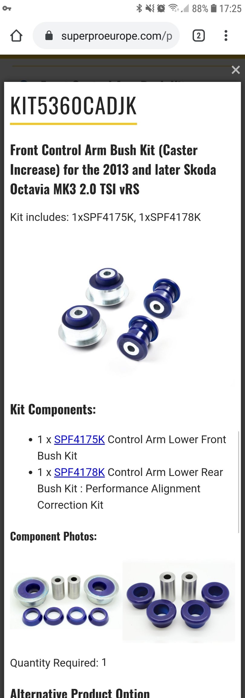

What pist0nbr0ke says is correct, the suspension is a different design and an alk is not longer relevant. I have the Superpro caster increase bushing kit that is mentioned as well as a Powerflex dogbone insert and it does a wonderful job of limiting wheel hop.
