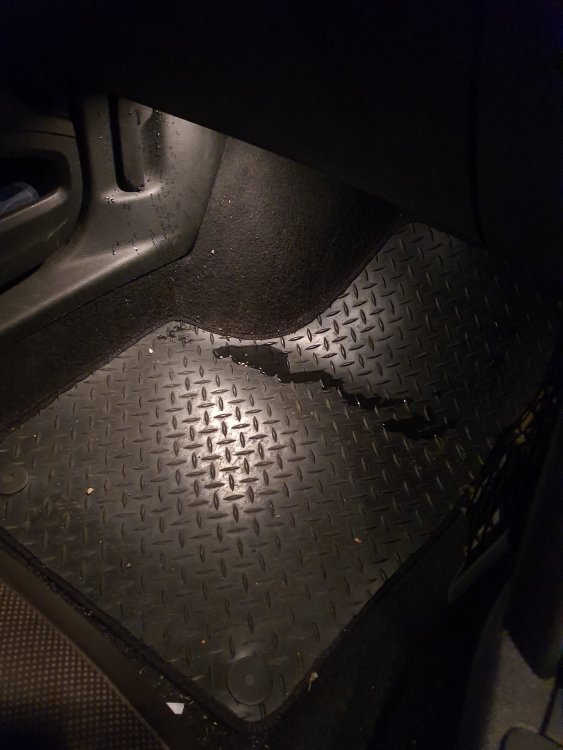

Hello everyone, about 2-3 weeks ago, while reversing from my driveway ive notice some water dripping on my feet as well some on the front passenger's side. Before water dripping, I hear a noise coming from the rear end that sounded like a bottle emptying.
Since then, every time when it's raining and the car does NOT move, water comes in on the front and rear passenger side. I have no idea where the rear side comes from, its just soaking wet. However, no water comes on the driver's side. It was just once.
While I guess it is the drainage of the pano, I have no idea where to look for that. Does anyone know how to fix this or anyone from Romford area can have a look at it?
2014 skoda superb estate with pano.

The one picture above makes me suspect the air filter looking at the drips on the bonnet release,
I'm guessing any leakage from a sunroof would follow the path of least resistance, which would be around the door seals and down the A-pillar trim. In this case it wouldn't surprise me to see water running over the bonnet release catch as it is directly below the bottom of the A-pillar. If the pollen filter was swamped then water would likely either drop straight through the lid and directly onto the carpet, or down behind the fan and straight under the carpet above the passengers feet.

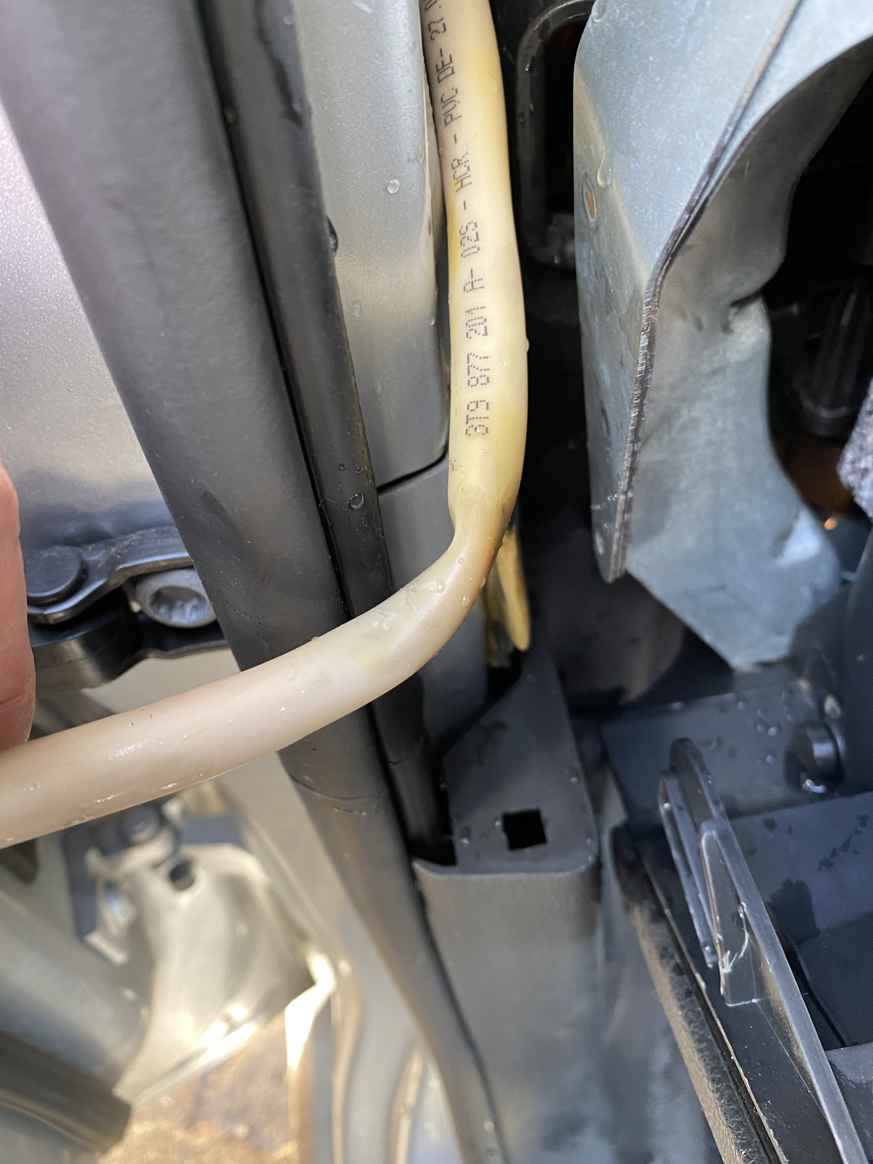

the issue was a stranded tube of the drainage "system". it worked like that since manufacture and by time it collected dust and got stuck. the mechanic cut that part and replaced it with a L shape aluminium pipe and everything works like a charm now. but maaan, the amount of water inside, jesus. hopefully soon i will have the required time to dry it as well. the back footwell was flooded because the water travelled to the back when the car was moving.
mystery solved, no silicon, no sealing, pano still works but with the regular and usual "cranks" and "clicks" noise now and then. but no matter what, i will never buy another car with pano, regardless of the brand.
so if this helps anyone, your pano might be ok, its just a damn tube that got stranded when they assembled the car.

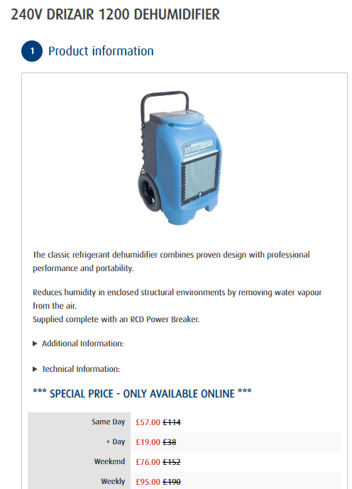

Given that winter is right around the corner it would be a worthwhile investment hiring a professional dehumidifier for the weekend.
Otherwise the car will be constantly misting up, perhaps even ice on the inside of the glass i.e. a thoroughly miserable experience.
Then there is the exacerbation of the infamous dry solder joints on the back of the dash dials, they hate excessive moisture.
Get the interior properly dried out ASAP, £76 well spent...

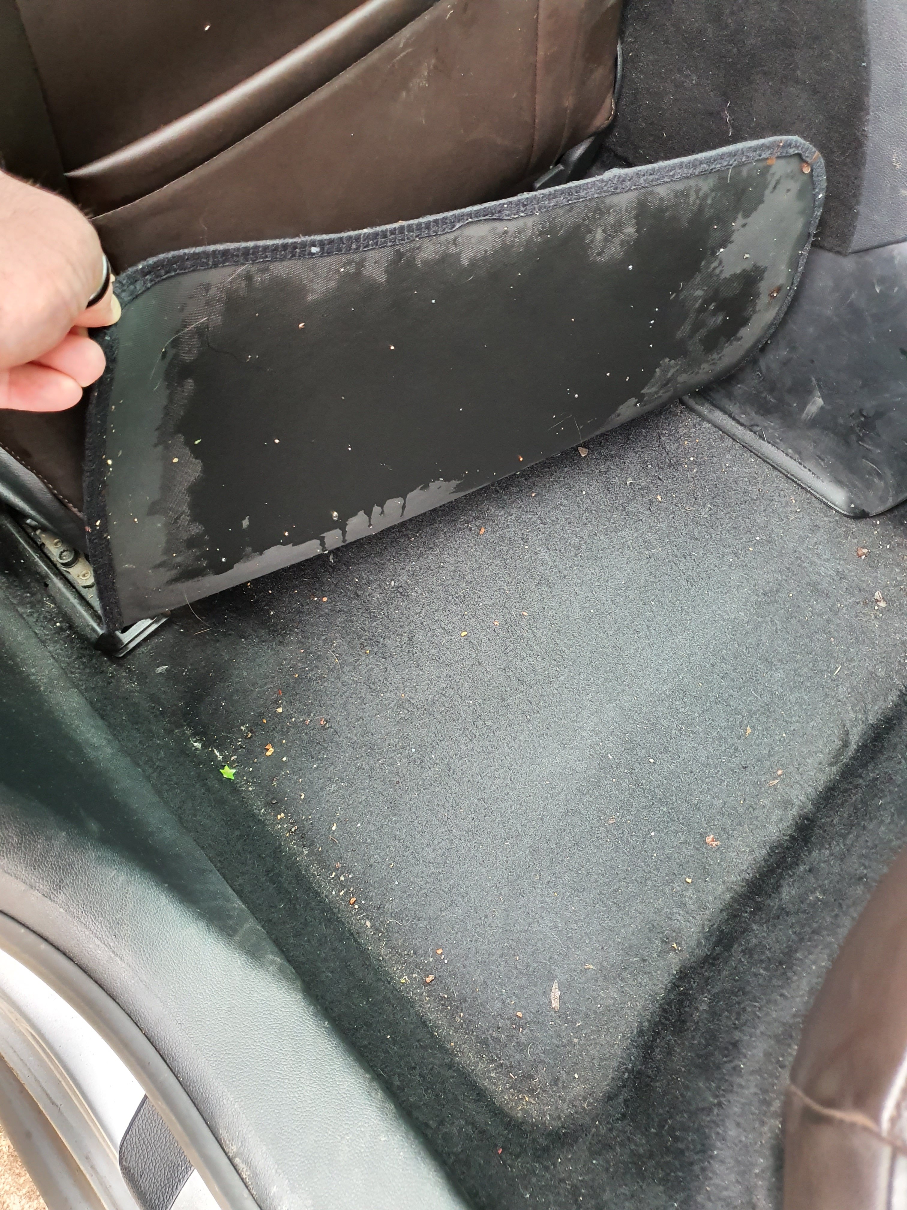

First time poster,I have the exact same problem. Rear passenger footwell absolutely soaking wet and front is also wet but not as bad as the back. I haven't got a sunroof on mine so any ideas where the water could be coming from?

Whereabouts was the narrowing of the pipe. i.e. before disassembly whereabouts between the roof and the exit point was the reduction in diameter?
that left metal thing where you can also see a part of that finger is the door’s hinge. hope this can give you an idea whereabouts was it stranded. or to be more precise, it is just where the bonnet handle is.
