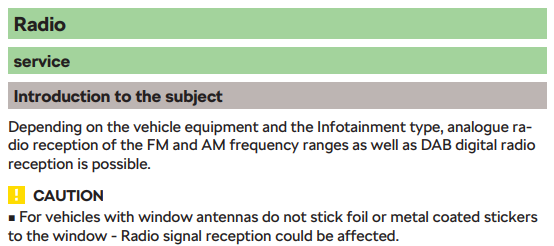

Page 146 of the owner's manual...
@silver1011 Thanks for this info, it makes sense as my 'utterly confusing ICE model' has FM/MW/LW radio as well as DAB/Satnav and SD card media (slot 1)..
