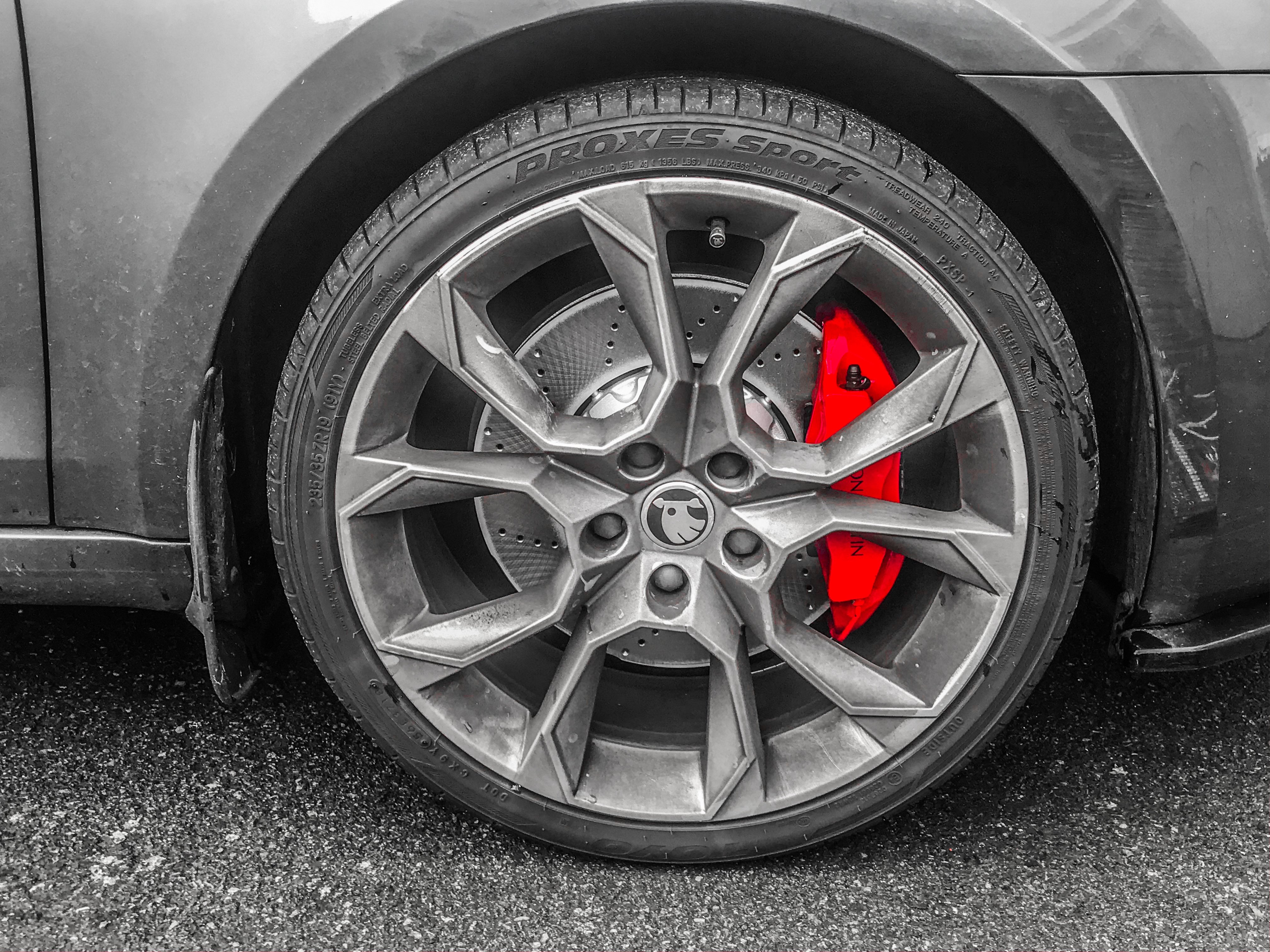

I’m brand new to the forums and I was looking for some input from ya’ll, I have just stage 2 my 2018 vrs , I’m running 19’s on all corners p zero’s.  Been driving it and def needs some stopping power.  Was seeing if anyone recommend a reasonable upgraded brake kit, without hurting the wallet to much,  looking at Brembo, any one with experience with these or or no good or something else?, thanks 🙂

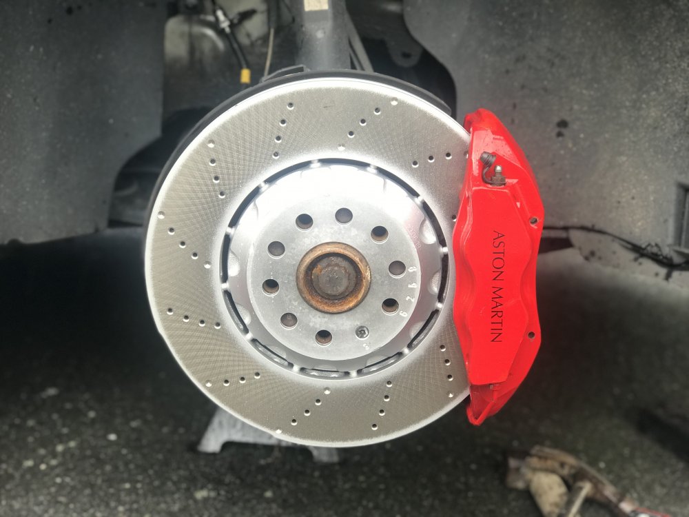

Below is my front brake setup, DB9 calipers, OEM spec pads, Golf CS discs and HEL braided lines. Done Audi S3 8P 310mm rear conversion too with Brembo discs and pads also with HEL braided lines.

For the front it was about £900. £300 for the calipers from a Polish exotic car breaker had the paint to touch them up at home anyway (it’s RAL3000 Red in this case), £330 for new discs, £160 for brackets and HEL lines, £70 for OEM pads, can get fast road for about £110-120 also did new fluid and RS3 cooling ducts in the deal. This is about as cheap as I’ve seen 4 pots fitted to an Octy and the car really stops now. I did Silverstone recently and was lapping with an IS38 equipped 380 bhp Octy on standard brakes and under

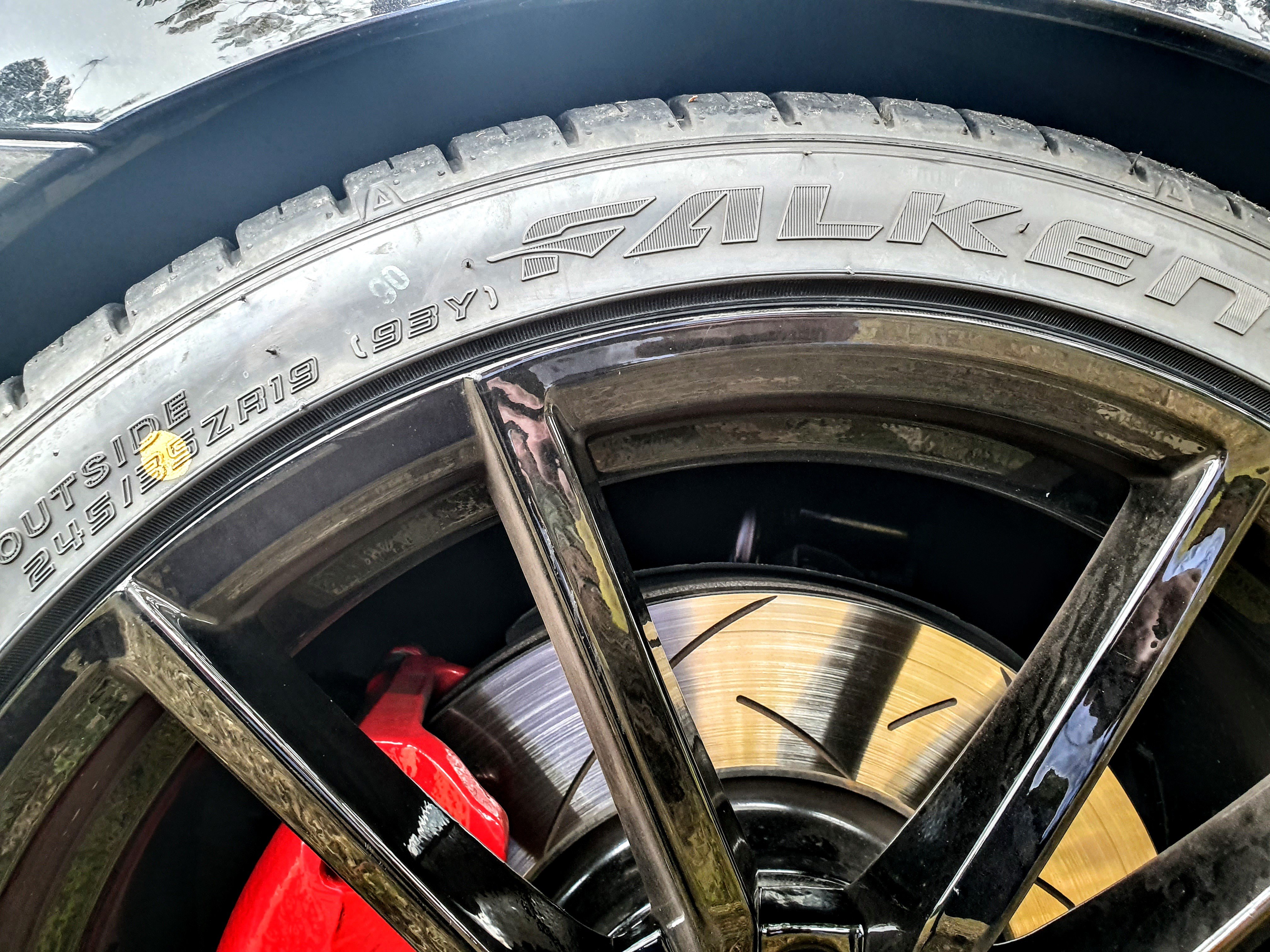

Anyway I went to DBA T3 grooved front discs and T2 rear with Forza FP3 street performance pads and the difference has been remarkable, they still have the nice bitey feel in usual street driving, much less dust and they don't fade at all on a backroad thrash and seem to be lasting ages. Yet to do a track day though.
