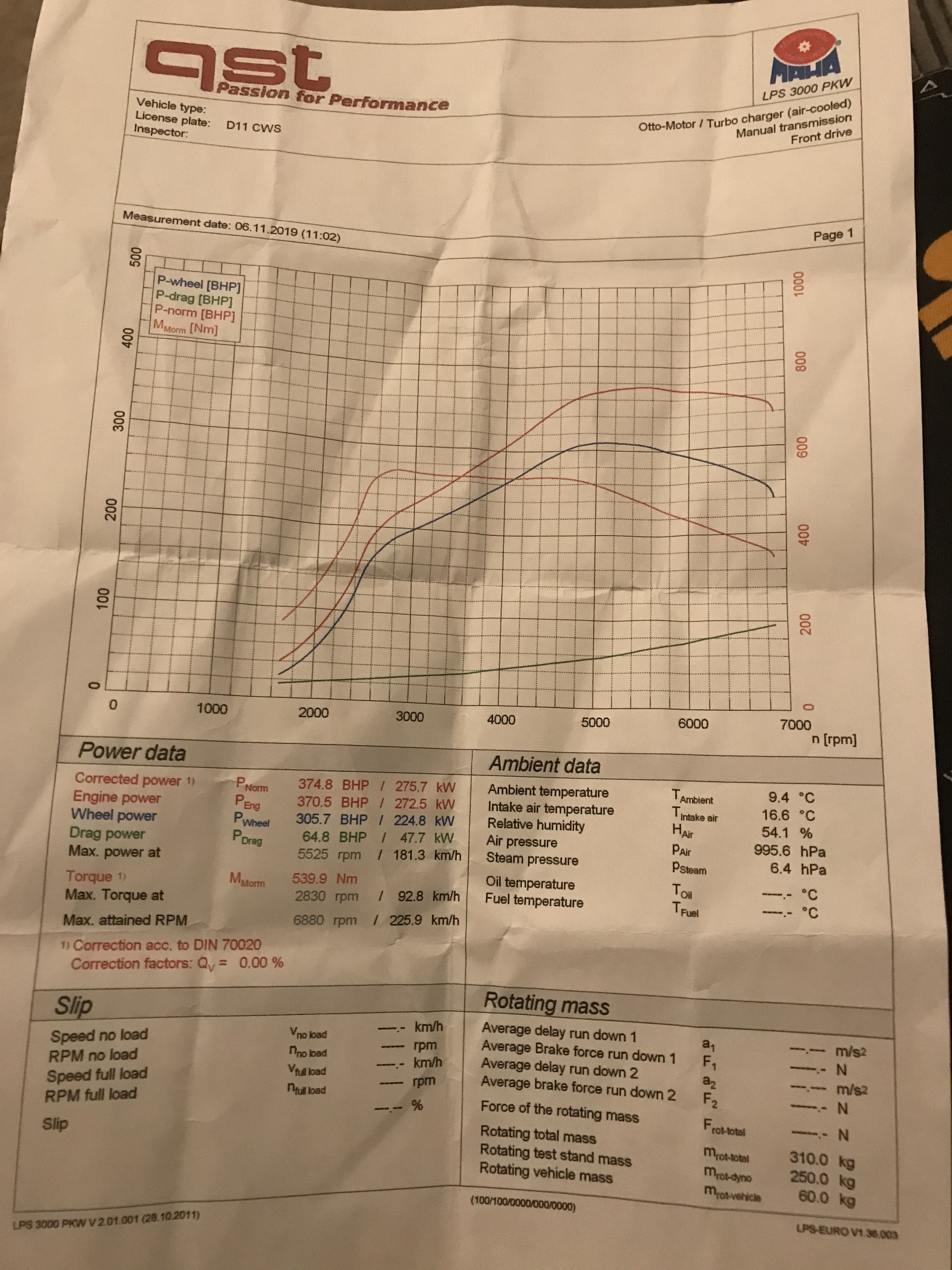

Haha, I have the Dyno read out 🙂
The 305 wheel horsepower is about lineball with others. Amazing results on the IS20 in any case, really keen to see how you go with the IS38 as I'm trying to find one as well.
