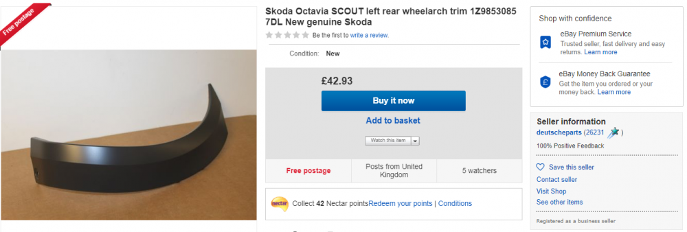

Ordering a new one from Skoda will mean you'll receive it unpainted, i.e. in black unpainted plastic...

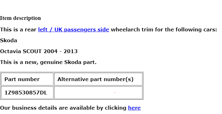

Here is one on eBay...
https://www.ebay.co.uk/itm/Skoda-Octavia-SCOUT-left-rear-wheelarch-trim-1Z9853085-7DL-New-genuine-Skoda-/172356069114

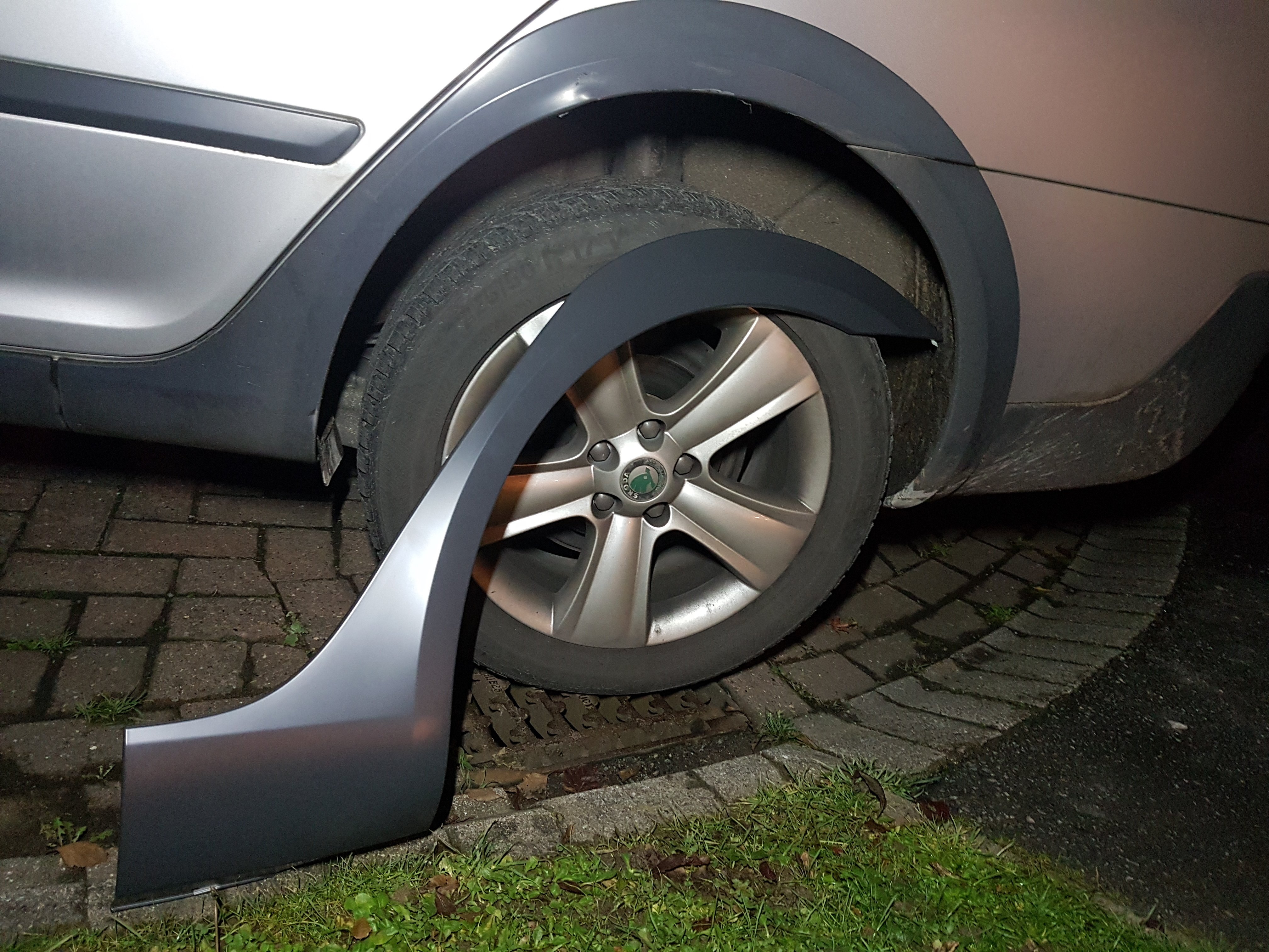

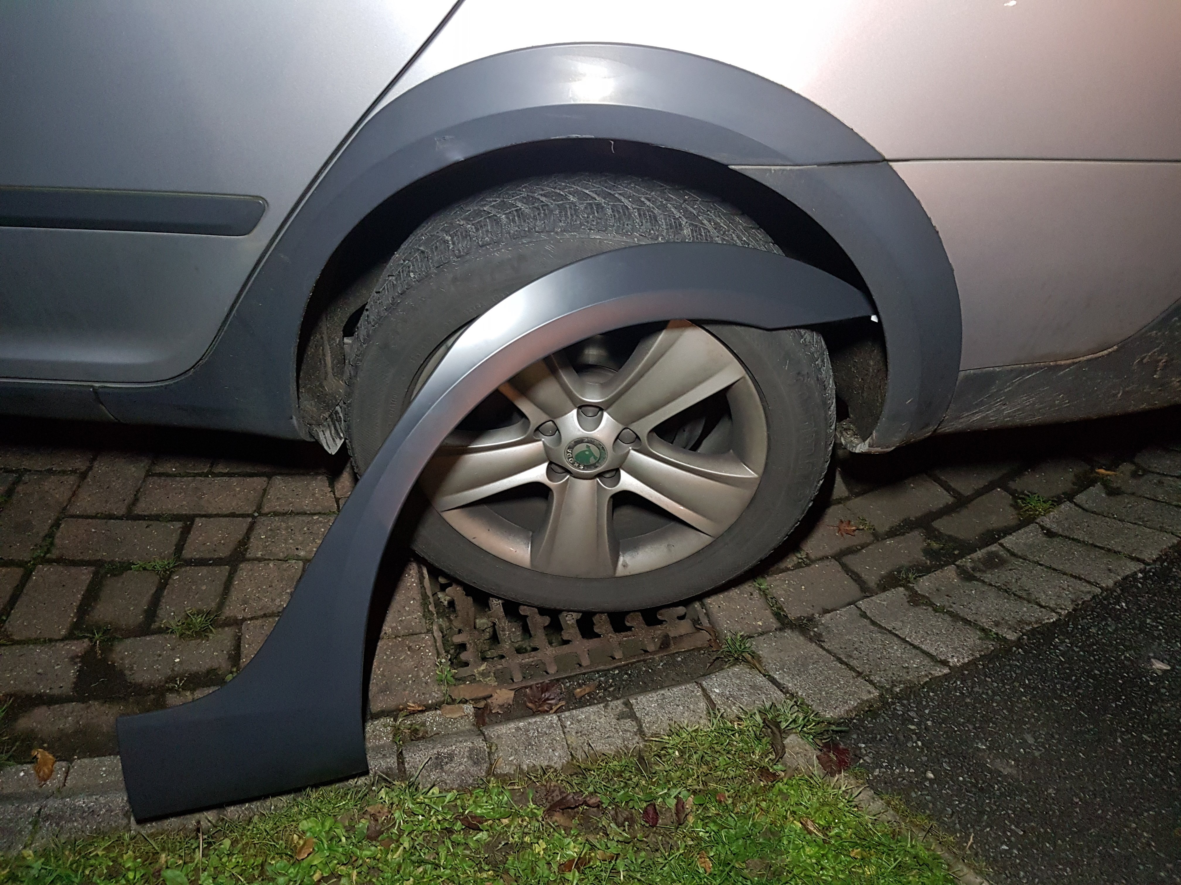

I picked up the new arch this afternoon and thought I'd add a photo of the existing (damaged) arch and new one together, so apologies for taking the photo in the dark...
It really doesn't look like the ones on my car are painted - and given the age of the car the new one doesn't look a million miles away in terms of the base colour of the plastic...?
Thanks for the pictures.
Was the new arch moulding supplied like that from the Skoda dealers parts department?
If so, then it does appear to either have been pre-painted, or is formed in grey plastic.
The MkII Scout has been around for a long time now, so there have been quite a few that have picked up parking scrapes, and even on mine after the wide ran up the back of another car, the grey 'coating' was removed to reveal black underneath.

Yes that's how the arch was supplied by the local Skoda main dealer yesterday.
In the flesh, it appears to be a smooth, bare plastic (darkish) grey finish. It's the same finish on the inside.

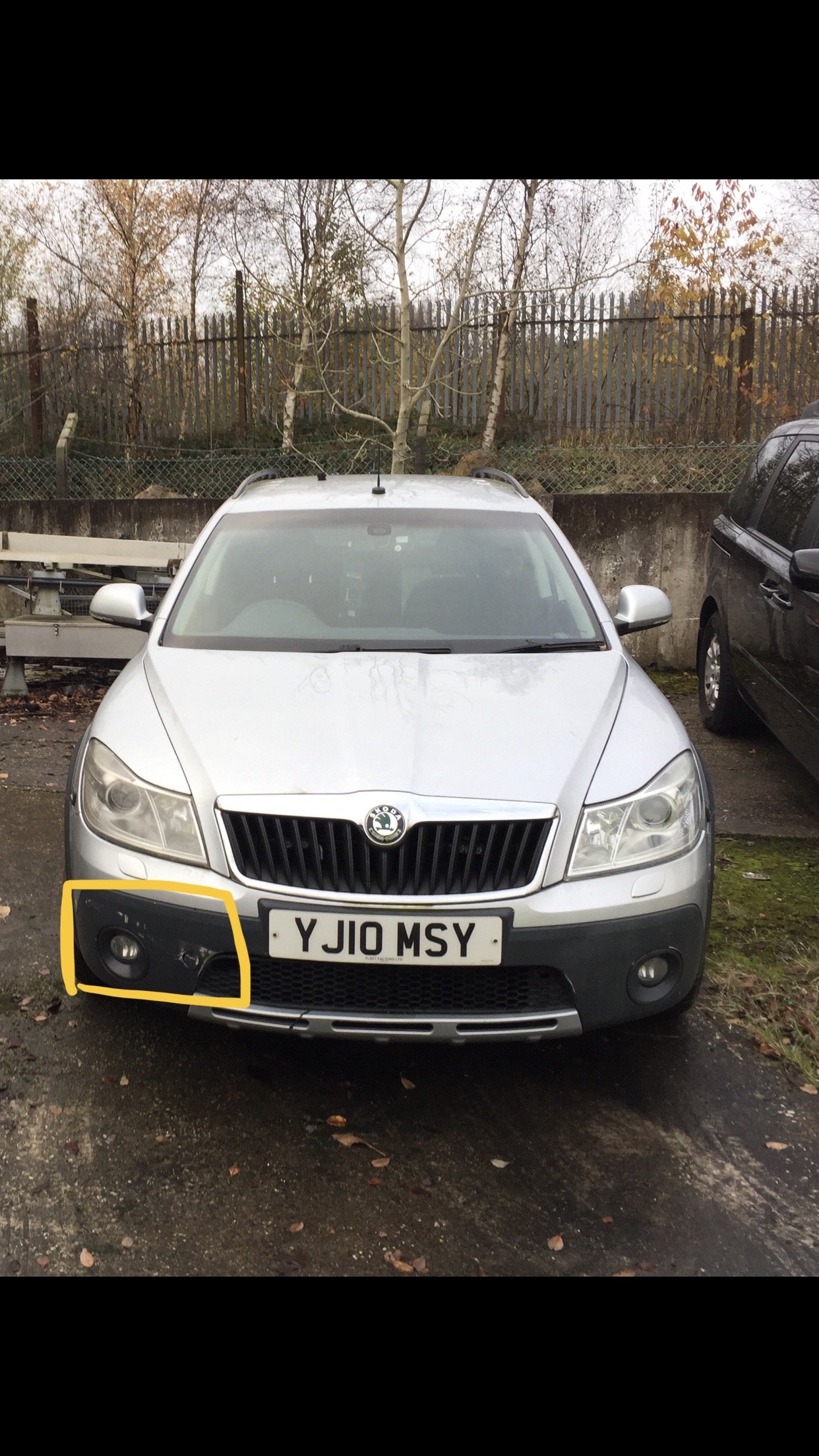

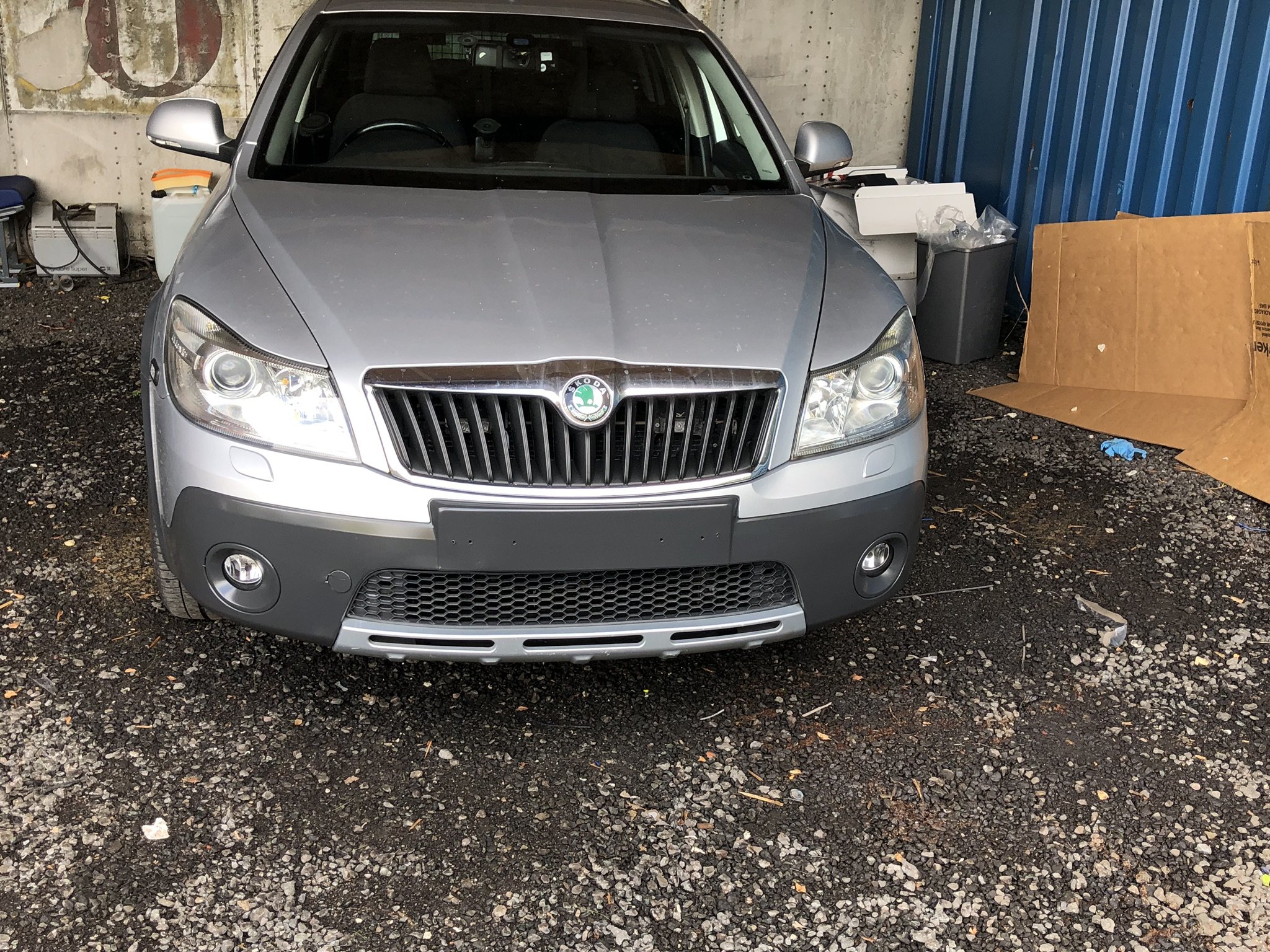

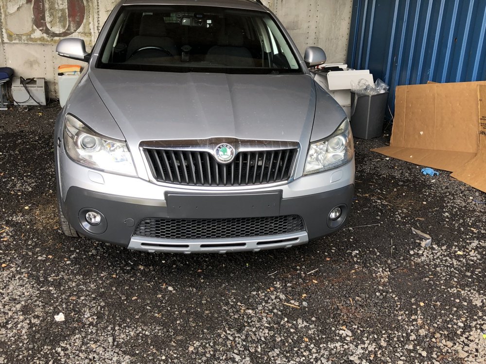

I have the proper Octavia paint codes as I have had to re paint the Matt “grey” part of my scout front bumper after some one kindly scrapped it in a minor fender bender incident, luckily no actual damage it just rubbed the “grey” colour away to reveal the white factory under coat. Mines a 2010 Octavia scout but I’ve been told a few times that ALL scout models have the same colour trim.
 It took a while as Skoda didn’t have a clue they could only confirm the metallic silver paint code... the only problem is I can’t give you the paint code yet as the rattle can is in my work van.
 I will include some photos of the difference
