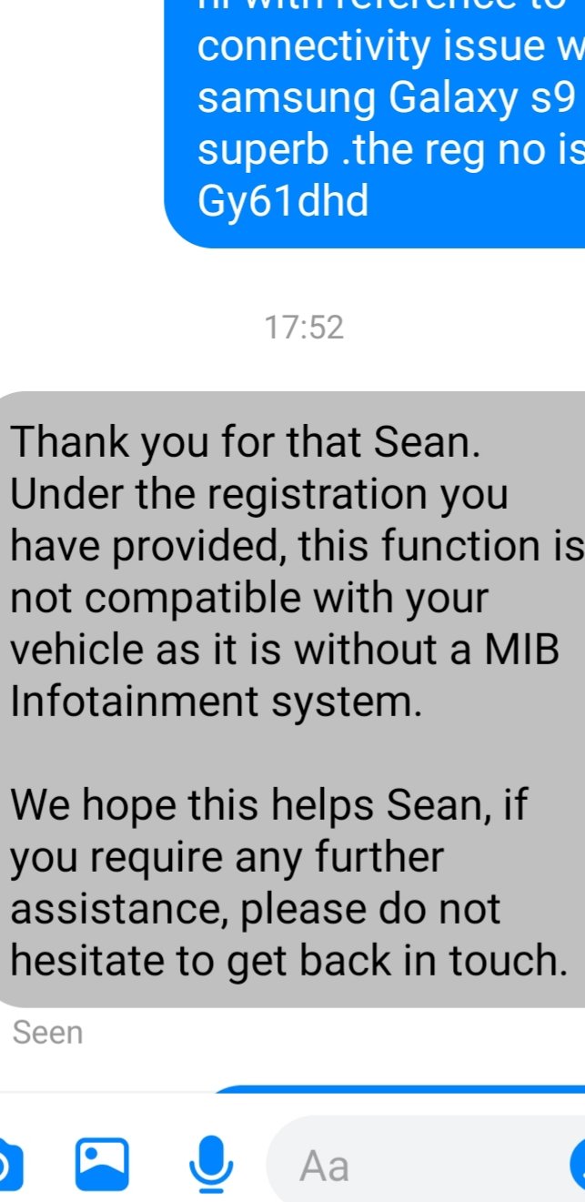

I have tried everything to connect phone to avail .
in desperation I contacted skoda uk who asked for reg number .below is their response .
please helpinbound2015585522859813757.thumb.jpg.f591c52f041a8dae21f55dc900b1ad36.jpg

What phone are you trying to connect? Until the Bluetooth module failed a couple of months ago, my 2011 ‘61 reg CR170 Superb Elegance connected to all the iPhones and a couple of Samsung phones I’ve had without a problem so I think SUK are providing you with utter bull****e.

You might also want to add what you're trying to do as the customer service message seems to think it's only a feature of the newer MIB headunits...
