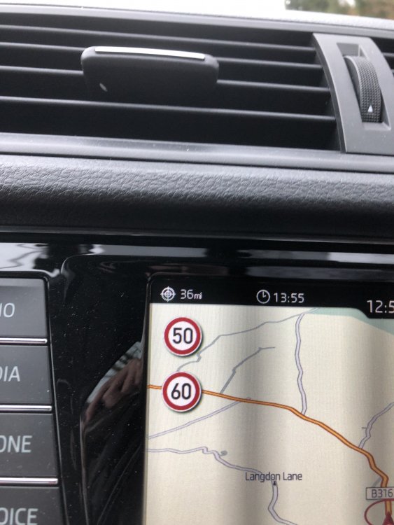

Erm - had a bit of a drive out over the weekend and noticed that on some roads [normal two lane carriageway] I get two speed limits. Also, on one occasion there was a no overtaking symbol with the red car on the left of the black one. Seems the wrong way around. Any thoughts? Have I got the wrong update [see post #1]? Thanks R-
If you're towing, the speed limit is 50, not 60, on NSL roads. Is this ever enforced?
This oddity has been commented on before and even if the tow option is not selected if still appears
Has anyone tried ECE 1 2020 before I go through the update process - again? R-
Yes that's the update I used
OK, thanks - maybe the "I'm not towing" thing will get fixed in a future update. R-
I commented on the double speed limit thing. Mines the same, i think I'm on the 2019 -2020 version. I'll take a pic later of the map version.
Some roads it doesn't even bother, like most of the M3!!
A bit useless really, they should look at the way Garmin do there satnav displays. Garmin worked perfect for me, just does what you need. Being a £500 option on the Fabia which is basically enabled by software installation as far as i can tell you would think they would have they're **** together as these systems have been in place for years!!
