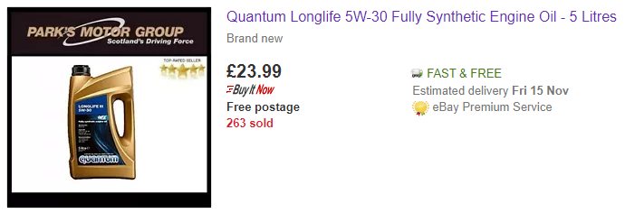

There is only longlife oil now, despite what dealers try and tell you.
They'll either be using Castrol Edge or Quantum Longlife III (VAG's own brand manufactured by Fuch's).
VW 507.00 is the key specification to look for...
https://www.ebay.co.uk/itm/Quantum-Longlife-5W-30-Fully-Synthetic-Engine-Oil-5-Litres/223613948218?hash=item34106e113a:g:ubgAAOSwk75dSZyD
https://quantumparts.co.uk/media/custom/upload/16444_Quantum_LONGLIFE_III_5W-30_Spec_Sheet_v4.pdf

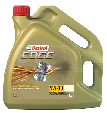

Costco were doing this Castrol Edge 5W30 last week at £15.99 + vat for 4 litres.  It's VW507
Just checked the bill for my first £179 service (another thread) which shows they used 5W/30 (I suspect Castrol LL) which is VW504/507. If it left the factory with VW508 which I think is 0/20 might emissions be up slightly and fuel economy down?  Though we might all fuss about oils I wonder if multi franchise dealers bother (my Skoda dealer isn't), I was once told they used the same in everything and no Fiat dealer I went to ever used the Fiat recommended oil it was always Castrol.
Note to Burchy - hope you cleared the shelves, Halfords charge £51 for 4 litres.
