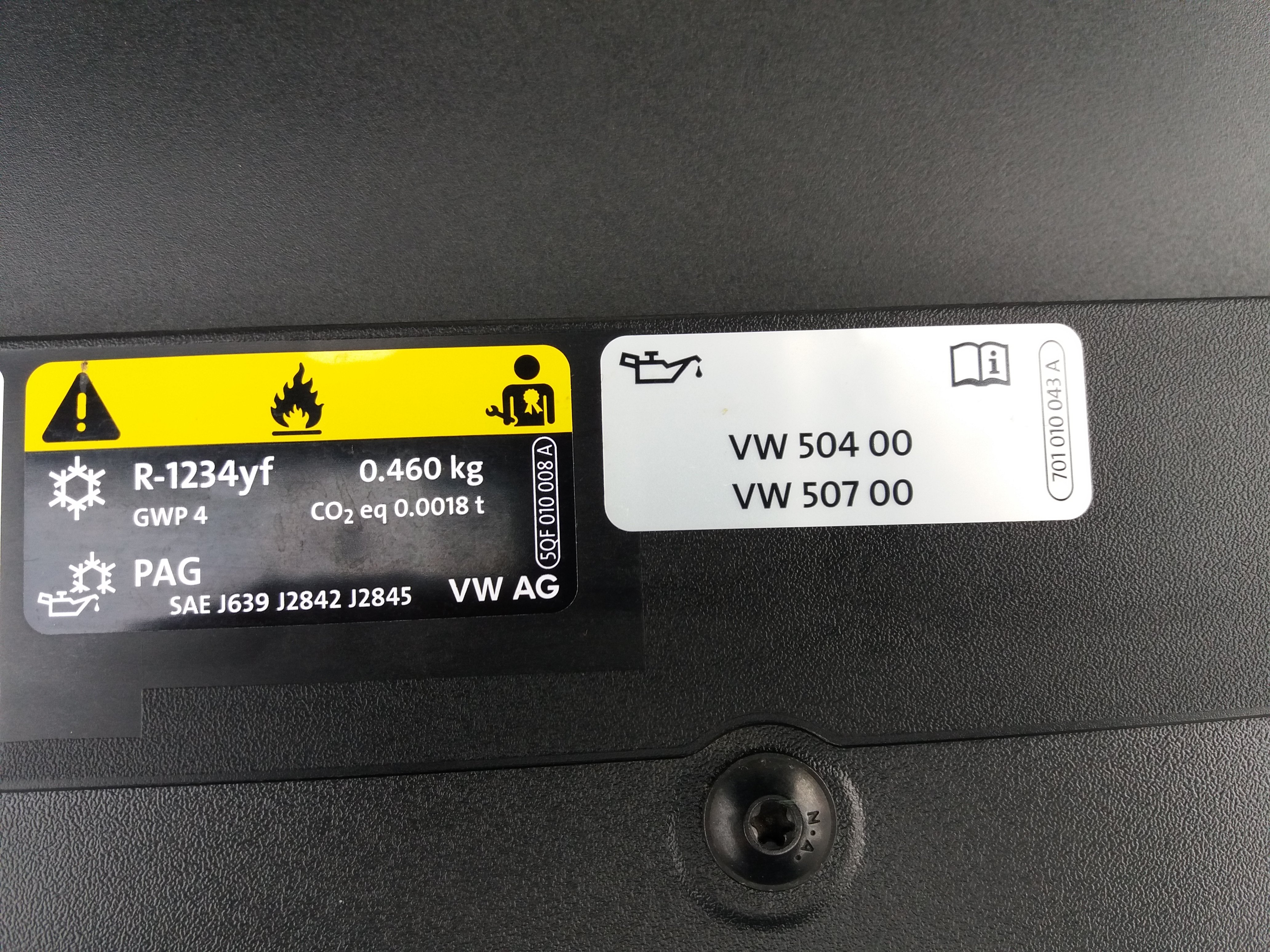

The latest VAG oil, VW 508.00 / VW 509.00 is 0W20 and is purely focused on fuel efficiency with it's lower viscosity. It is rumoured this is what cars are being filled with at the factory in order to satisfy the manufacturers fuel efficiency claims.
However, come the first service the dealer network is reverting back to VW 507.00 oil which is 5W30.
Ignore the information in the owners manual, this is out-of-date as soon as it is printed. Instead, lift your bonnet and check the slam panel. This is my 1.4 TSI 150PS Kodiaq.
Note it recommends VW 507.00...
