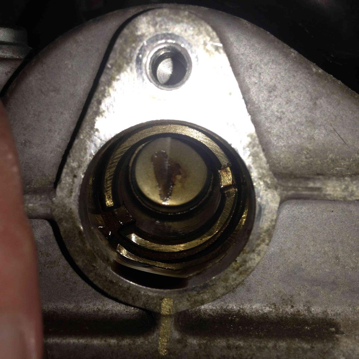

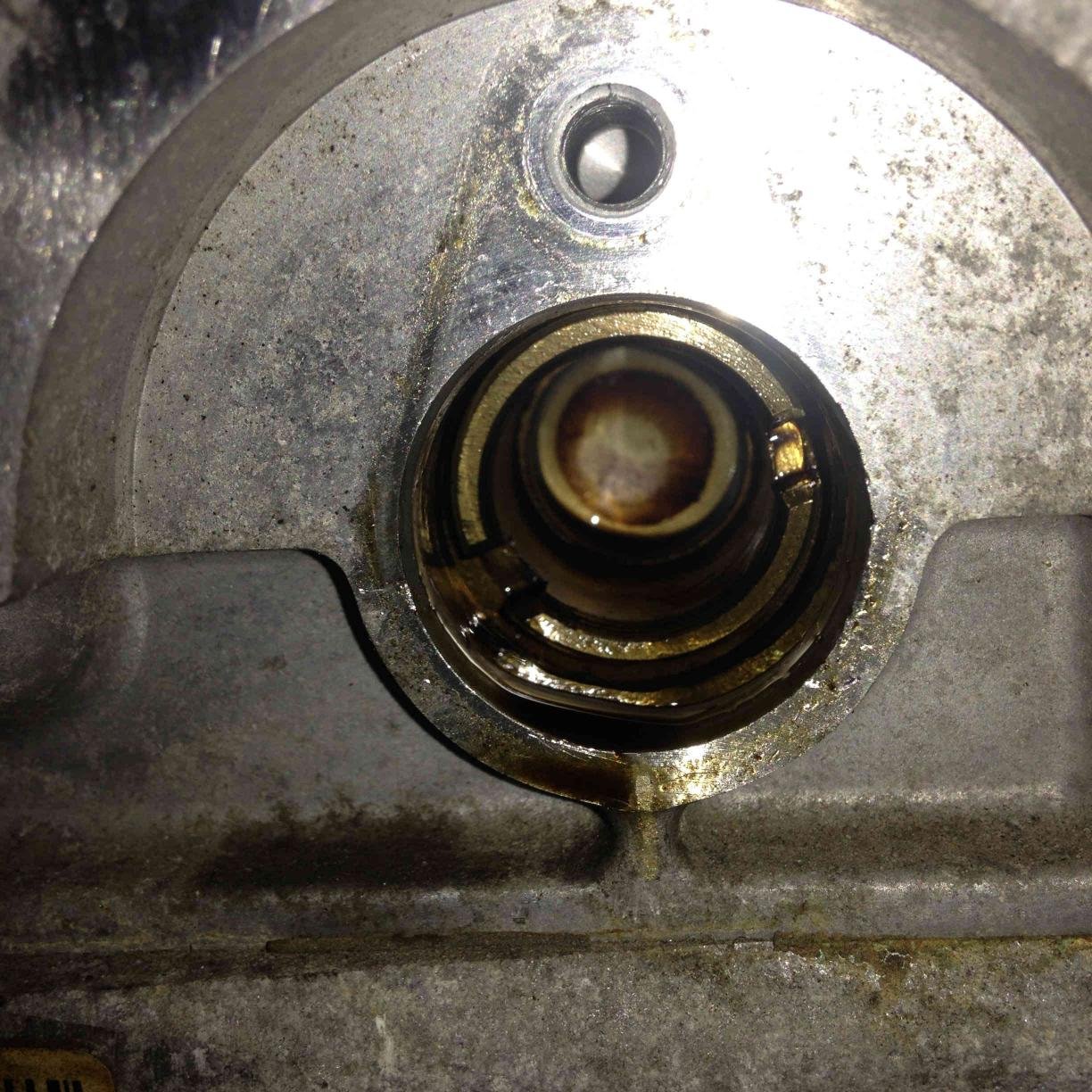

Using a mm graduated rod through the plug hole to determine TDC on No.1
cylinder, we observed the angle of the notches on the end of the
crankshaft by removing the plastic end covers, and photographed the
misalignment that was indeed present, according to forum information that
at TDC the notches should align parrallel to the face of the cylinder
head.  Is that correct, and does anyone have an authoritative source for
that information?

We have calculated an angle that we believe the timing to be out by based
on the published length of the stroke (86.9mm) and the 11mm we measured
the piston rose by before levelling off, after the notches had already
aligned parrallel to the cylinder head:  22.78 degrees, which at 10
degrees per tooth (is that accurate?) would indicate at least a jump of
two teeth.  Have we got that right based on those figures?  The actual
angle from the photos looked possibly steeper than that, but some of that
could be going past TDC, but before the noticeable fall of the piston.
Measuring the rise after the point of camshaft notch level seemed a more
reliable guide to the actual angle of error though.

On 18/11/2019 at 23:14, NeilTM said:
according to forum information that at TDC the notches should align parrallel to the face of the cylinder head. Is that correct, and does anyone have an authoritative source for that information?

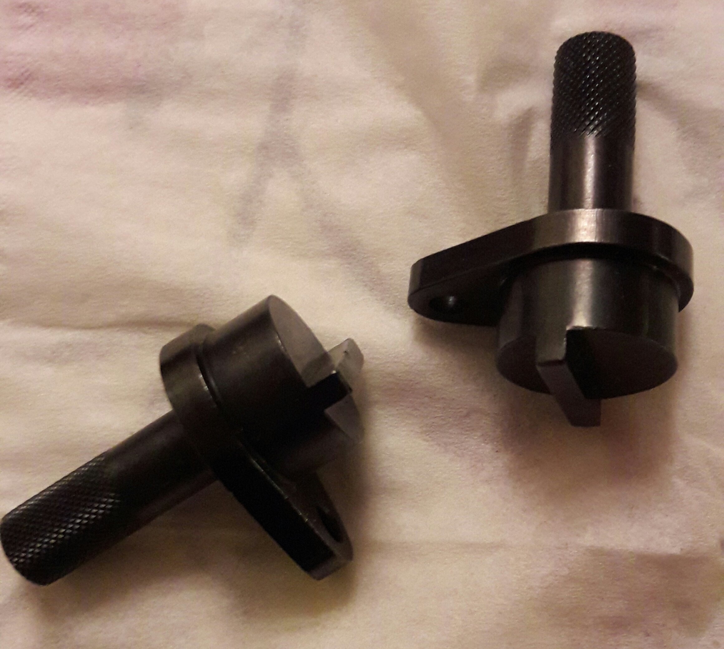

Following up this, the locking tools that are used during chain removal/replacement fit into these slots on the cam ends, and will only do so when the slots are parallel to the head/block joint (due to the fixing screw in each).
They will also only fit when the cams are at TDC No.1 on the compression stroke (when the off centre slots are above centreline of each cam, as opposed to below, as yours appear to be).
Whether No.1 is at TDC compression or TDC exhaust won't make any difference to the misalignment angle though.
Picture of a pair of cam locking tools:
Any damage caused by this timing offset will already have been done, if there has been any, I think; so a further 20 miles isn't likely to do anything more.  @Tech1e, would you agree?

But this gives me the confirmation I sought, thank you.  The camshaft locating tools are indeed 'authoritative'!, and I can take the laptop in if they want to argue the toss, but they should know this anyway.
Wish me luck with them for tomorrow morning.
