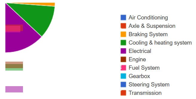

Nikolay, Skoda Superb is not too reliable on electrical system.
See below a pie chart extracted from reliabilityindex.com
Those are percentage of faults.
Edited by RicardoM
