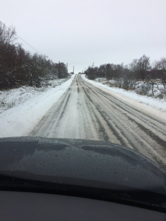

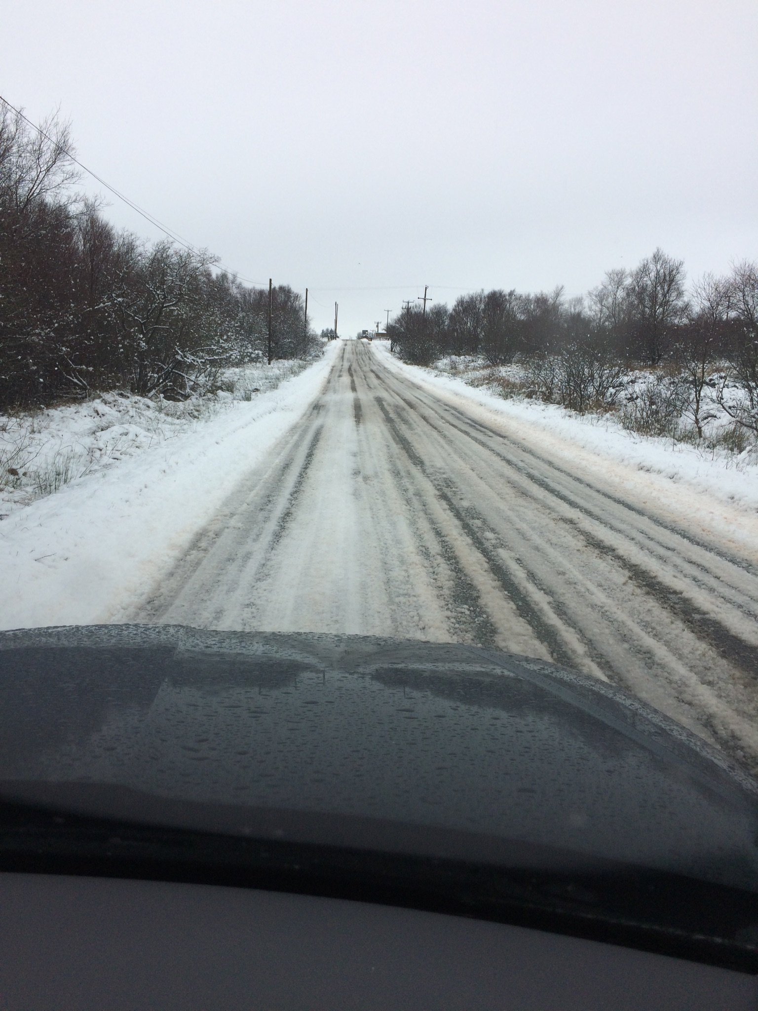

I selected Snow Mode today and the thing I noticed most was heavier steering than I normally use.
I guess it “weighted up” to Sport steering.
I think the throttle response had softened up too. Though not as bad as ECO mode (which has been banned).
ps - this was the view on the return leg of my journey, after the snow had cleared a bit. Car was rock steady on Conti 850s.
