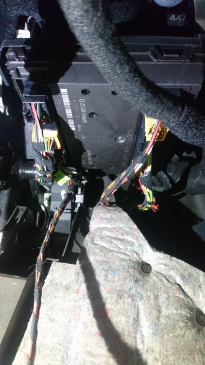

Cheers wino. Do you happen to have any pics of where it actually is located?
Pretty confident I (or an electrical engineering friend!) could swap the relay but I'm not sure how to get it out (pics seem to have gone from your original link)
I've found it - pic attached.
Does I need to essentially unplug everything and pull it out?
Whilst I was in there I noticed a lot of condensation on everything. Beginning to think this might be the beginning f the end for the vehicle!

Moisture inside these cars can be a problem for all manner of the systems, because the interior electrical connectors are not waterproofed like the ones outside the cabin.
Can't remember if you've described leaky rear door carriers in any of your other posts, but that's the most usual cause of interior moistness.
It could be that the connector which feeds the wipers had condensation in it, but it could also be that the relay contacts are worn, scorched and pitted, making them unreliable.
Fix any and all the leaks you can find as a first step.
