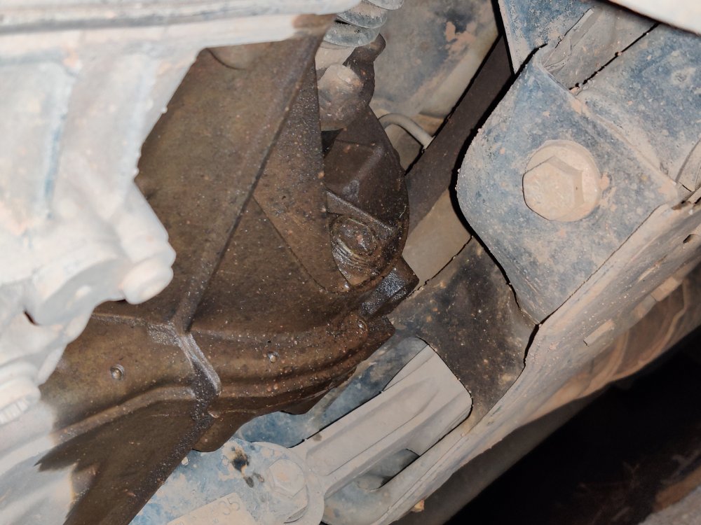

Hi all, this is my first post in this forum. I own a Skoda Fabia mk2  1.4 tdi with 100000km (60000miles) resently when i got my car washed when i noticed a leak near the drive shaft and gearbox housing. I found out the gearbox shaft oil seal is on its way out. So i want to tackle this job as a diy as i dont trust any mechanics or garages near me. The only problem that i have is I'm unable to find the part number for the seal, since in India it's very difficult to get the spares for skodas i would like to know the part number for the outer gearbox oil seal so that i can buy it before i start the job as i dont want to get stranded after removing the seal since this is my sole ride😅.IMG_20191202_185128.thumb.jpg.ef14313ff95c4aab7adf1501bfa108ac.jpg

Item 9A here then, I think, 02M 301 189B
https://skoda.7zap.com/en/cz/fabia/fabi/2010-706/4/409-409017/
How much is it leaking? It's fairly normal to see a certain amount of leakage there. Certainly not worth bothering with unless it's dripping onto the road/driveway.
You should really replace the driveshaft bolts and make sure they are tightened to the correct specification when fitting new ones, item 3 here https://skoda.7zap.com/en/cz/fabia/fabi/2010-706/4/407-407022/
There's also a special grease you're supposed to use on the seal, this stuff I think: https://www.ecstuning.com/b-genuine-volkswagen-audi-parts/radial-shaft-sealing-grease/g052128a1/
Not sure what happens if you don't use it, or use some other grease.

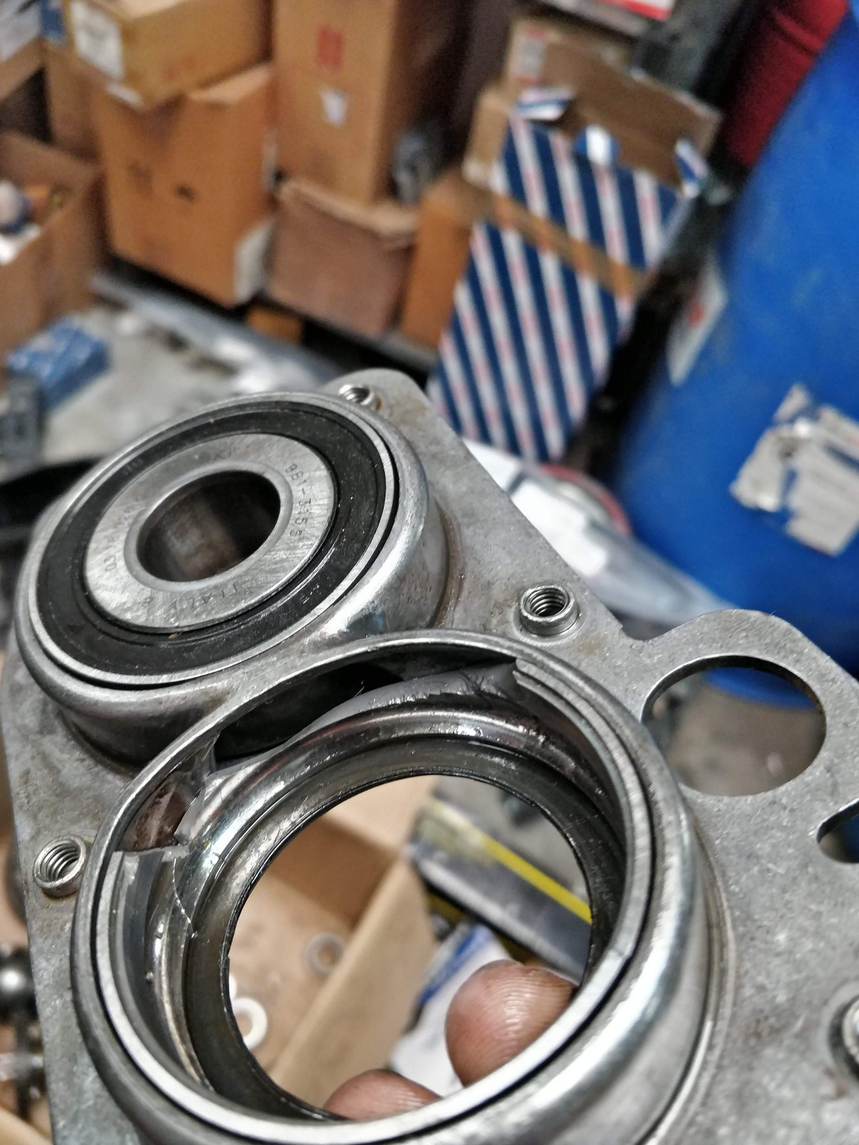

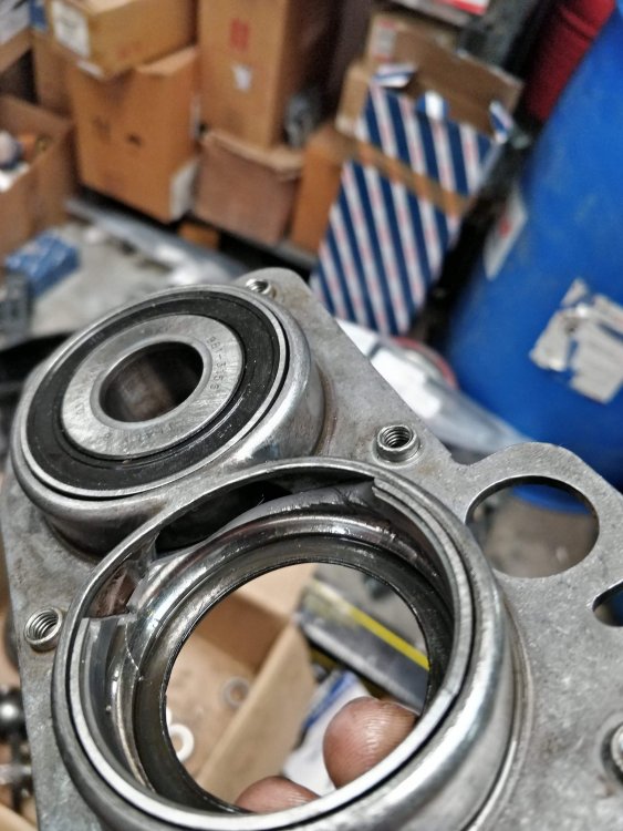

Thanks for the early reply. I will get a look at it, I'm just worried since i had a catastrophic gearbox failure at 95000 km and had to rebuild the whole unit and it wasn't cheap.
  • Sponsor
Which part failed?
The 2 bearing mounted on a plate part no 02T 311 206EIMG_20190808_170123.thumb.jpg.d67b440776c3382e6017d4ab12091b4e.jpg
  • Sponsor
Wow, big failure! I changed a gearbox on my partner's Fabia (2005) for noise coming from that bearing pair (I think, still haven't stripped the old box to find out).
