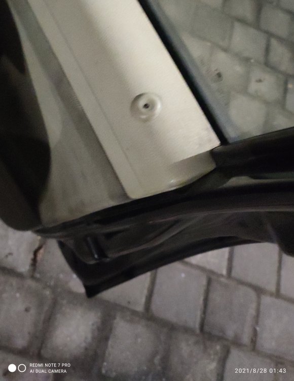

Round LED not blink driver side door
I have a Skoda fabia mk2, can any one tell me why this driver side door led light isn't blinking, earlier it was blinking and what's the use of this light? Can we enable disable this with VCDS?

How to check it's working or not? Because this LED isn't blinking from last coupe of months.

No, if I tried to start the car with only key blade it's stopped and immobilizer icon flash in instrument cluster

I changed the red led and issue resolved. So the LED was fused.
