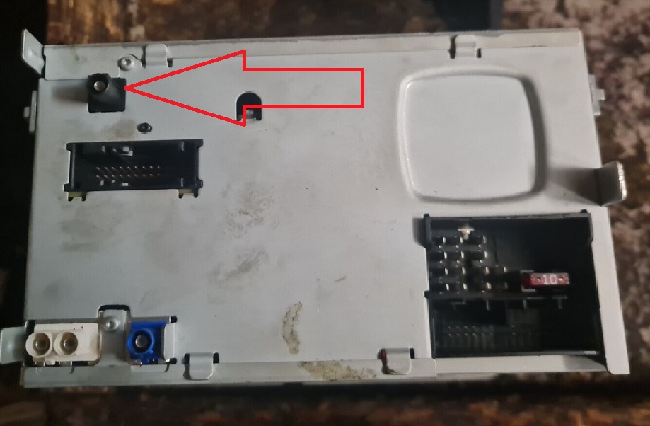

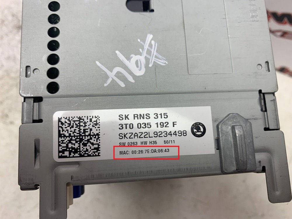

make sure if your looking for bluetooth and DAB that the unit has it, there is many with both, either or neither, To confirm bluetooth is present you need to see the label and the MAC address populated (attached image), if its all 0's then no bluetooth.
DAB is an addtional Fakra connector (black usuually) up in top left area on the back of the unit (arrowed attached image)..............So moral is, don't just buy a RNS315 hoping for all the bits because lots don't have any of them.
Edited by UrbanPanzer
That's exceedingly helpful actually.  I knew about the mac address but not the fakra connector.
