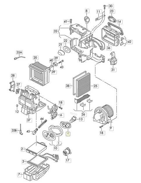

Is it the manual control or automatic? Manual part appears to be 6Q2819453C and is component 31 here

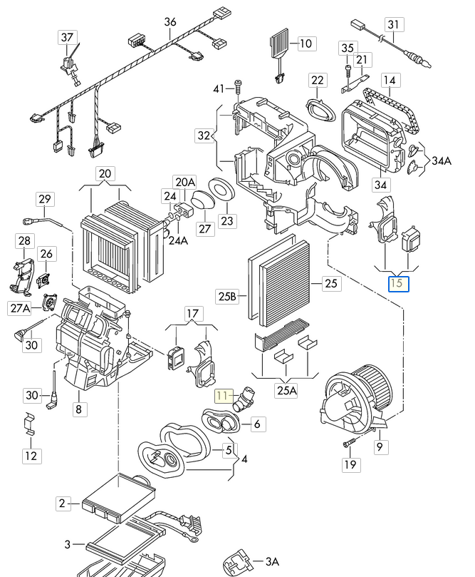

For the automatic climate control it looks like 8Z2819453B (V71) number 15 in this diagram
