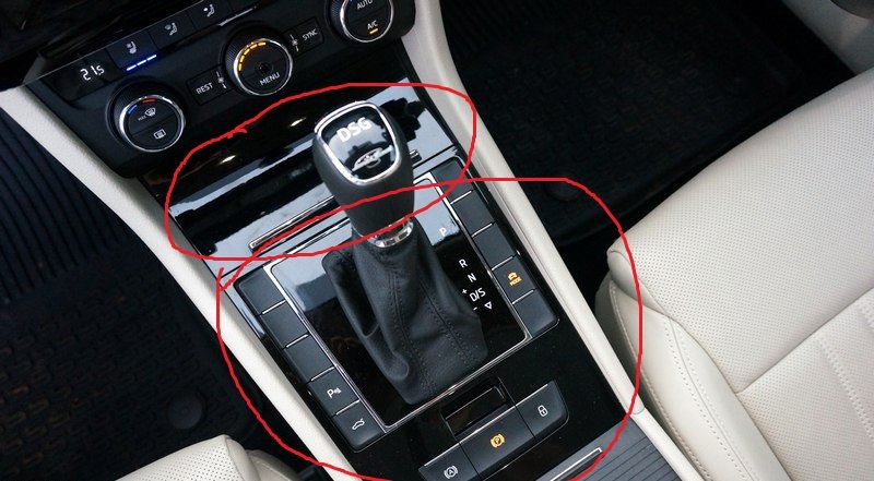

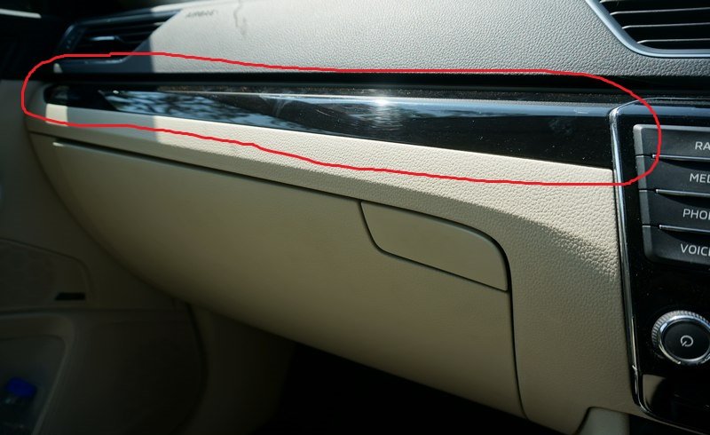

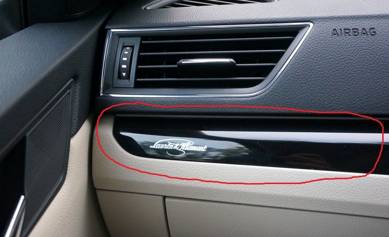

I recently purchased a Pre owned skoda superb and I found that the interior Piano Black trims are all scratched up so I decided to cover them up with Vinyl however, I am quite a newbie to all these mods.
I have no idea how to get these trims off so I can wrap them.
So far I have tried to pry them with a plastic trim removal tool but the tool just broke and got stuck between the trim and soft touch material.
Any help on removing these trims would be greatly appreciated.
PS: Pardon my image editing skills

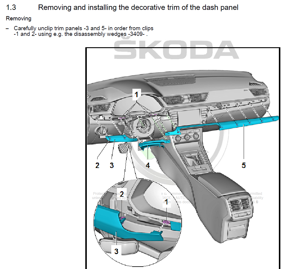

If you absolutely want to try to remove the trim, here's some info on the center console. The side trim pieces should just pop off. Be aware, see if you can buy a set of plastic trim removal tools, don't use a metal screwdriver or something, you'll end up doing more damage. And also keep in mind, in my experience cars are built once. They are not made to be taken apart and rebuilt again, especially things like trim. The possibility of snapping off a tab so you end up with badly refitted trim pieces, or even worse, rattles and squeeks is there. It can be done, but be careful.
