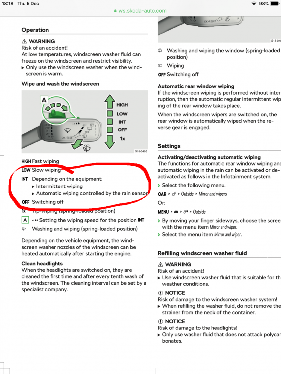

The wiper stalk has to be in the first up from off position for auto wipers and the sensitivity can be adjusted with lever on top of stalk, all of which is covered in the owners manual.

I thought that was the position for intermittent windscreen wiping and the sensitivity increases or decreases the time between wipes?
I'm expecting wipers to operate when rain is sensed by the car?
When you have auto wipers you don't have timed intermittent, you have automatic rain sensed "intermittent".
For the wipers to operate when rain is sensed you MUST have the wiper switch in the intermittent position. Off means OFF!
D'oh!
That makes sense, thanks for your answers guys. I was getting a bit confused dipping in and out of the manual trying to get used to all the bells and whistles. Way more tech than my 67 plate focus estate had.
