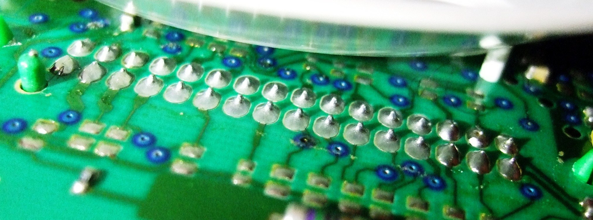

It could also be a cracked solder joint at the green connector on the instrument cluster circuit board. It comes in on pin 15, adjacent to the one in this picture labelled "coolant level".
check all the joints for cracks carefully while you're in there, if you do have a look.

Thanks Wino - lots of useful info.  I had a look at the solder joints but couldn't see anything out of the ordinary.
