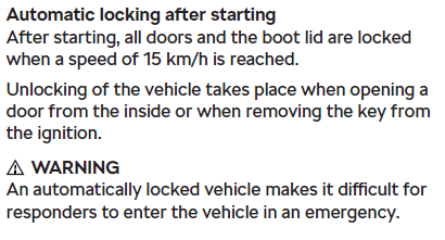

Hello, this is the 2nd Octavia I have had and there seems a big problem regarding getting locked in. My other half went into a shop, leaving me in the car and (due to a good habit) locked the car as he walked away, at first I didn’t give it a thought, but the sun was out and soon getting too warm inside and I tried to open a window…. No….open doors…no, being a silly woman, I started to get a bit panicky but soon he appeared as all was well but it left me thinking this could happen again. Eventually I bought a key which would open windows and doors but not start the car. This was kept in the glove compartment as a source of relief it the scenario happened again.
As I loved the Octavia so much when it reached about 7 years, we purchased a new E-Tec petrol hybrid which is a very nice car.  This a kessy type key and I asked my man to sit in the car and I locked him the car, but he could not get out. (I did let him out eventually) 🤣
Seriously, this is such a clever car why cannot a person be able to let themselves out?    This such a safety let down and I’m terrified to get locked in again.   Can anyone shed some light on this please. Can you get a  Kessy key to just unlock the doors?
I know they are very expensive but if I was trapped inside again, I know I would be safe with a key in the glove box.
