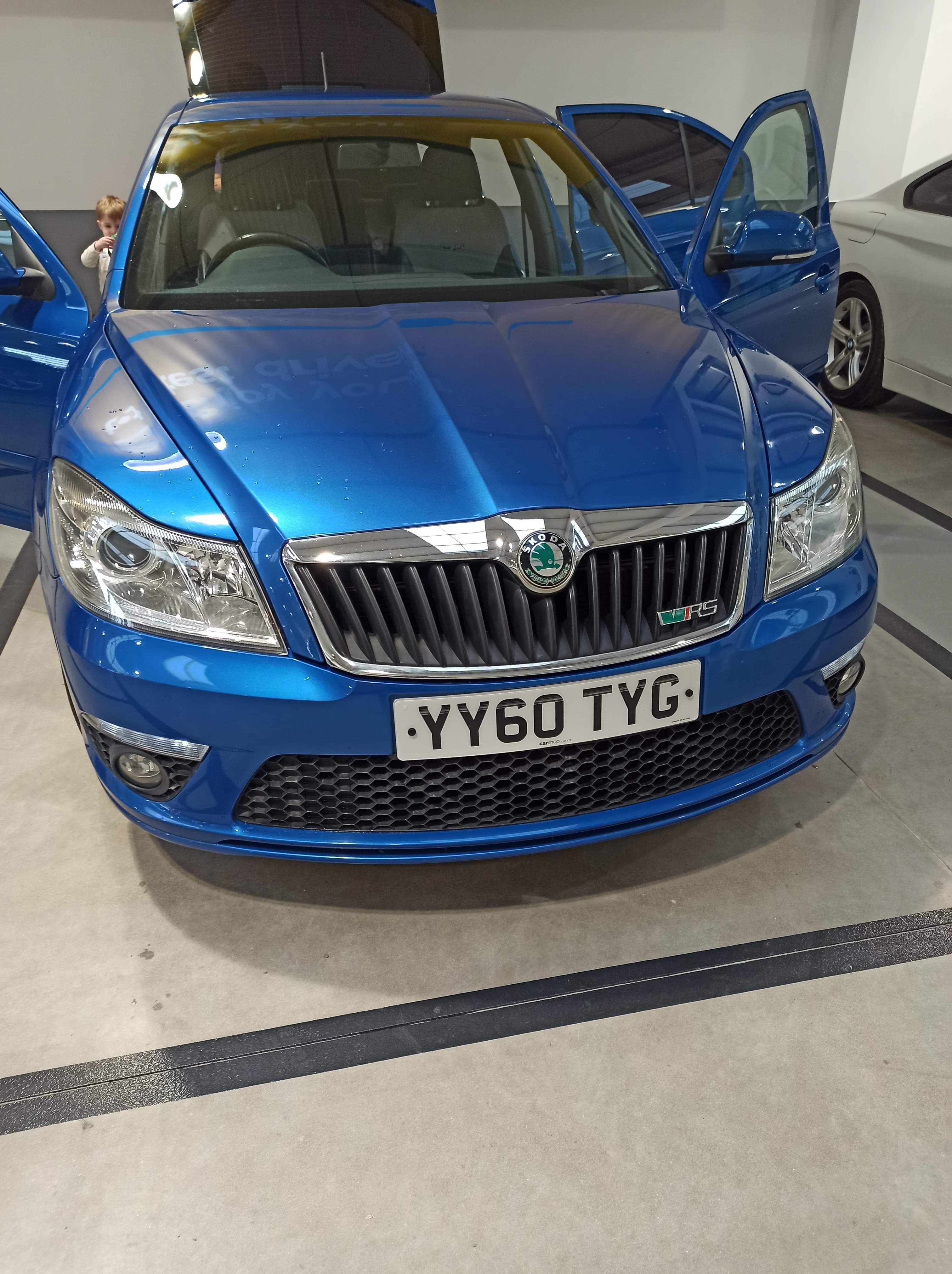

So I picked this up Yesterday, with the intention that @EllenHyuga will learn to drive now.
Specs:
FL vrs tdi dsg
Race blue
Cruise control
Rear parking sensors
Rear tints (not factory but done well)
Aftermarket nav unit (seems ok, will upgrade eventually)
So it's done 70k miles, full Skoda service history and everything has been done to the letter. Drives beautifully, this is my first auto car and I can safely say I'm a convert.

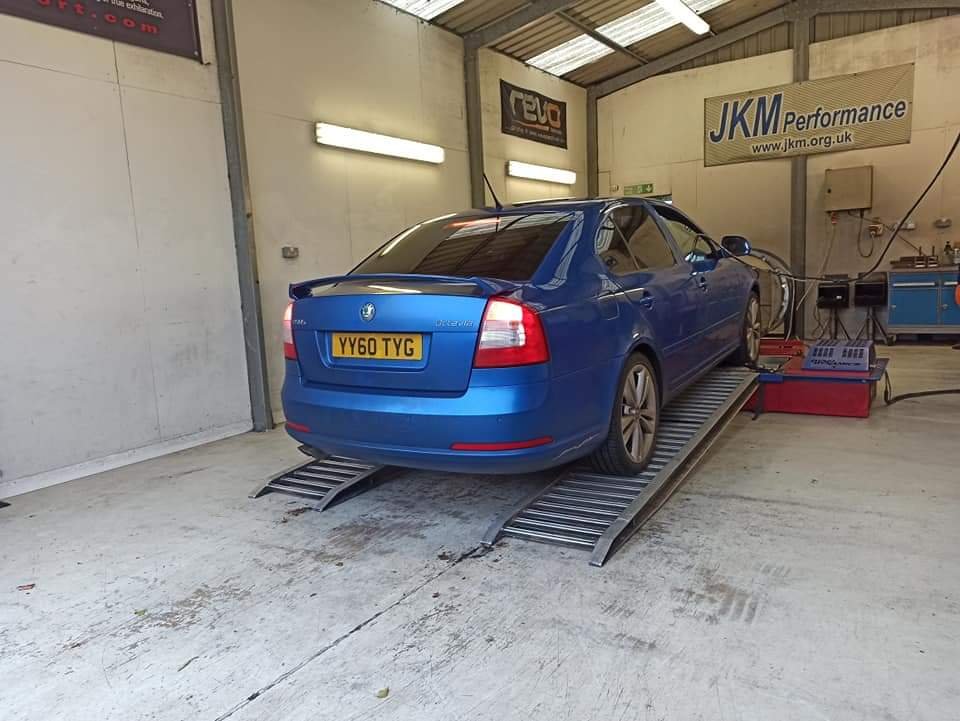

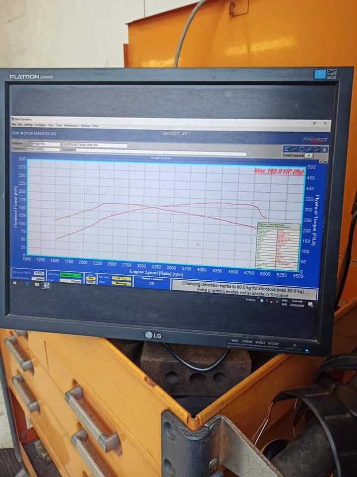

Went along to the JKM dyno day today, pulled some pretty impressive figures for a standard car.
Correct your engine should produce 168bhp same as my Dad's 2012 Superb with the same 6 speed DSG. Think the standard car is rated at 320nm what did yours produce because this a good indicator of a remapped car. For example 400nm is 294lb/ft.:thumbup:
