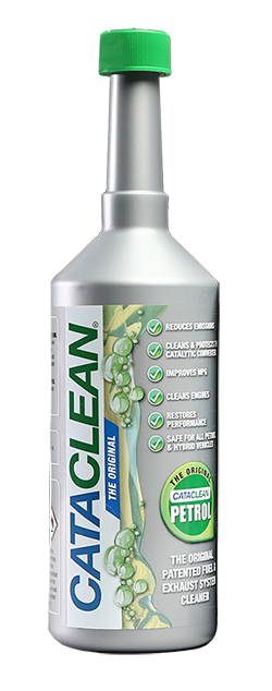

Got the car through the MOT using a bottle of this:
I'd go with the "Italian Tune up" as well  take it at 70mph for at least 60 miles in 4th and absolutely redden her ! A private road is very useful as well for up and down through the gears !
When you stop if she isn't making pinging noises as she cools then you haven't gave her enough wosskey!
